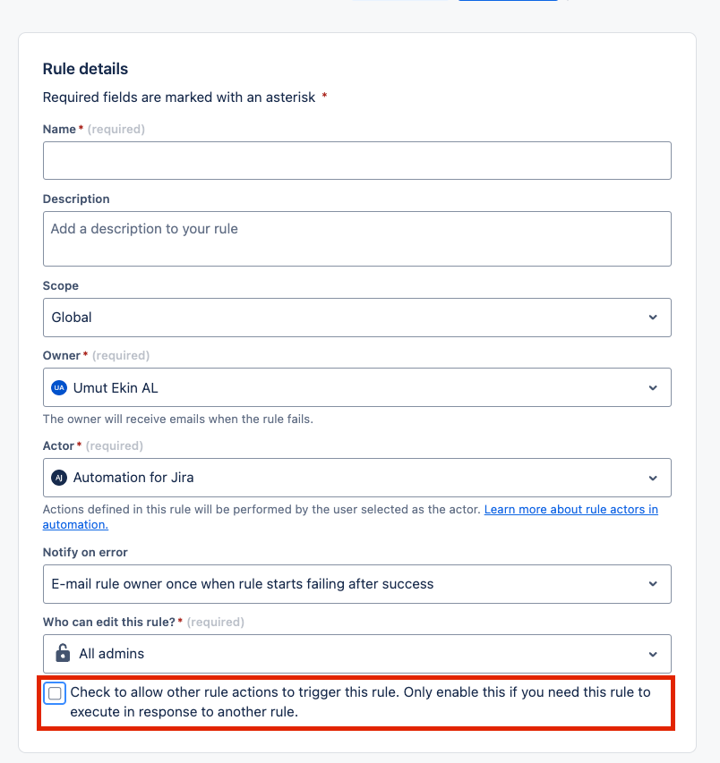

Hello @Robin_Janott ,
did you check the button I attached below.
If the issue is resolved, you can accept for this comment.
Hope this helps.
Umut

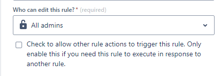

John Funk
May 24, 2024
Hi Robin,
Be sure the box is checked at the bottom of the Rule Details page of the rule to allow other rules to trigger it.

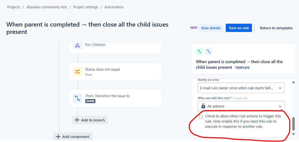

Valerie Knapp
May 24, 2024
Hi @Robin_Janott , thanks for your question.
It sounds like you need to indicate on the rule that sends the email that it should also be triggered by other automations, which you can do here -
This is just a template rule as an example, I just wanted to show you where the option is.
Please can you test this and share your feedback if it resolves your issue?
Thanks
