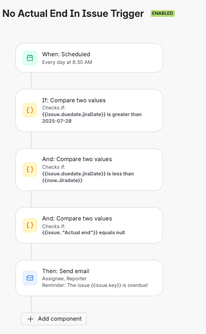

Hello!
I need to set up an email reminder to colleagues to add an 'Actual End Date' to Jira tickets so we can monitor on-time tickets versus late/early tickets, etc.
To do this, colleagues must fill in the aforementioned field. To help remind them, I have set up an automation to email them once the due date has passed and the actual end date remains empty.
Automation set-up
When: Scheduled every day @ 08:30 AM
If: {{issue.duedate.jiraDate}} > 2025-07-28
And: {{issue.duedate.jiraDate}} < {{now.Jiradate}}
And: {{issue. "Actual end"}} = null
Then: Send Email
It seems pretty basic, but the emails are not being sent. If I create the Jira ticket for a manual trigger, it works successfully.
Thanks

When using a Scheduled trigger you must have a step to select the issues of interest. This is done by defining a JQL within the trigger itself or using an action after the trigger to get a list of issues, like the Lookup Issues action.
You don't have an action after the trigger based on the images.
Do you have a JQL statement in the trigger?
If you don't then the rule doesn't know which issues to use the Conditions against, and no actions would be taken.

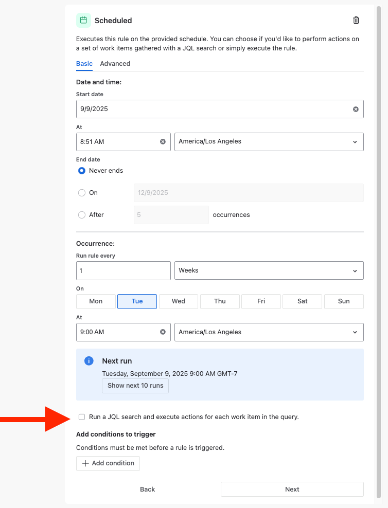

When you have confirmed that is returning the correct set of issues, add it to the Scheduled trigger.

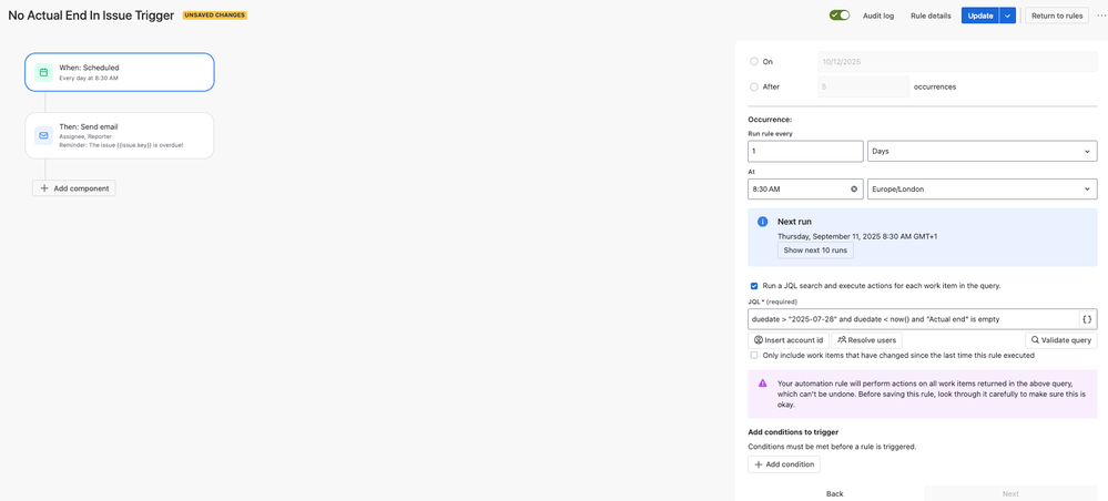

Check the box for "Run a JQL"

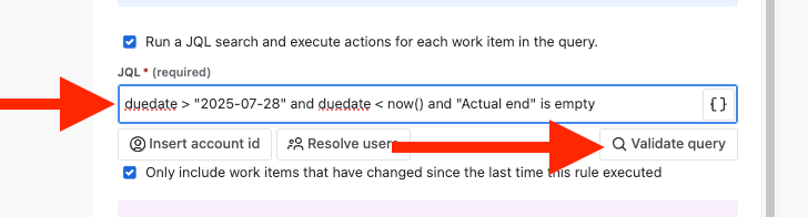

Paste in your JQL and click the Validate Query button

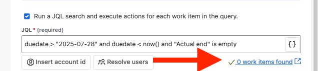

The Validate Query button will change to show the number of issues that match your JQL, with the Project Scope in the Rule Details page being applied.

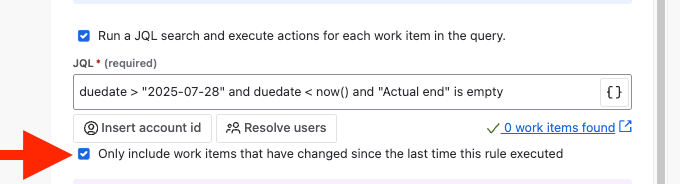

Then you need to decide on whether to leave this box checked, or uncheck it.
If you leave it checked you will get fewer issues. The rule will not pick up issues that have not had some change since the last time the rule ran.
After making the above changes to the trigger you don't need the conditions at all. The only issues that will be considered are the ones that already match those conditions.
Note that this will result in one email per issue found.

Thank you very much for your replyScreenshot 2025-09-10 at 10.10.42.png - very helpful.
So I have left the rule in this state (with JQL add to the conditions to trigger in the schedule bracket).
Let me know if we think we will have 'lift-off' tomorrow?
Thanks
Trudy P Claspill
September 10, 2025
That should work.
Did you use the Validate Query button to confirm that the JQL retrieves issues within the context of the rule?

I think the issue is in the notation of the last condition
set this as {{issue.Actual end}} or {{issue.customfueld_xxxxx}} (where xxxxx is the id of  the field)
Or
If you set the last condition to be a JQL condition.
"Actual end" is empty
Like Steven Sutherland likes this

Matteo Vecchiato
September 9, 2025
Hi @Steven Sutherland ,
Welcome to Atlassian community and thank you for your question.
Could you share a screenshot of automation and the automation audit log?
In the audit log should appear the detail of why the conditions haven't been accomplished or errors.

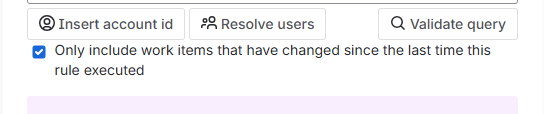

Matteo Vecchiato
September 9, 2025
Please be assure that this condition in the trigger is un-checked:
The automation seems ok, I suggest to remove debug it removing each condition in order to understand what is the blocking condition.
