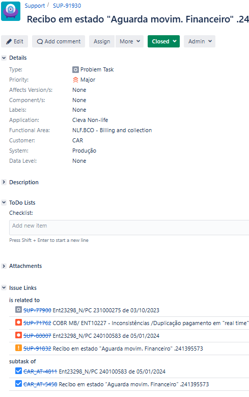

project in (SUP) AND "resolved" <= -8w AND level != "Contains personal data" and issueFunction in linkedIssuesOf("issuetype = 'problem task' and resolved <= '-8w'")
Example:

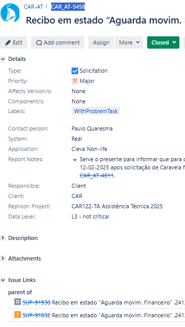

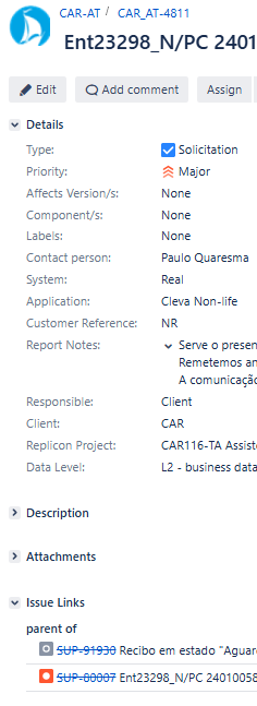

  • SUP-91930 Problem Task
  • There are two ‘Parent’ that are Solicitation
The goal is to load the ‘Data Level’ for each SUP resulting from the JQL selector, inheriting from its parent.

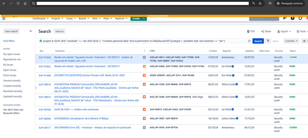

Have you first confirmed that the JQL selects the correct issues?
If so, then I think the problem may be that you have created an artificial parent/child relationship using generic issue linking, and the automation doesn't consider the linked CAR-AT issue to be the "parent" of the SUP issue.

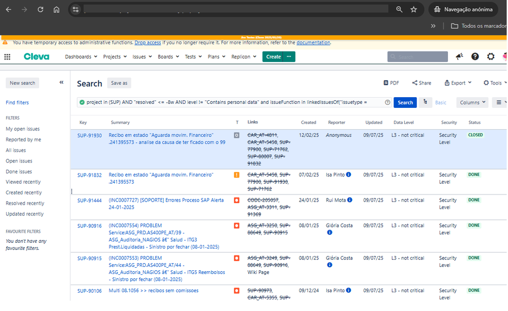

I have first confirmed that the JQL selects the correct issues:

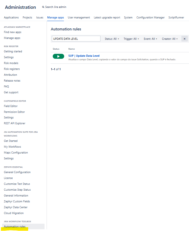

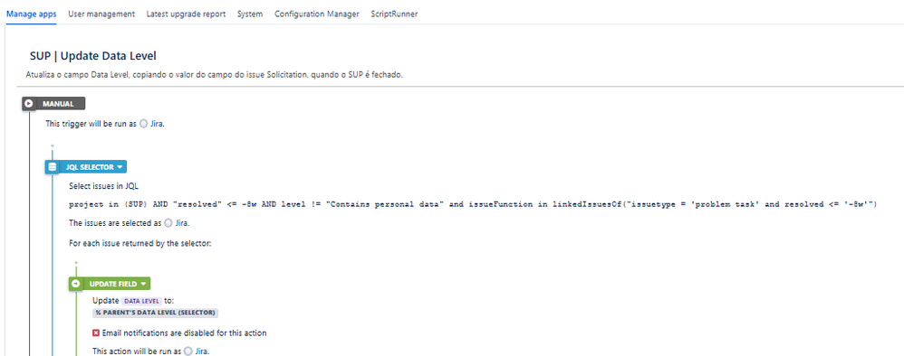

  • "Automation rules"
  • "SUP | Update Data Level "

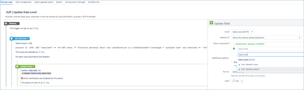

Did you use the Expression Parser Test Page to test the expression you are using against one of the issues retrieved by the selector?
Trudy P Claspill
July 8, 2025
Also I'm having trouble finding information in the JWT documentation about using "selector." as part of the expression. Do you have a link to reference material that demonstrates that usage?

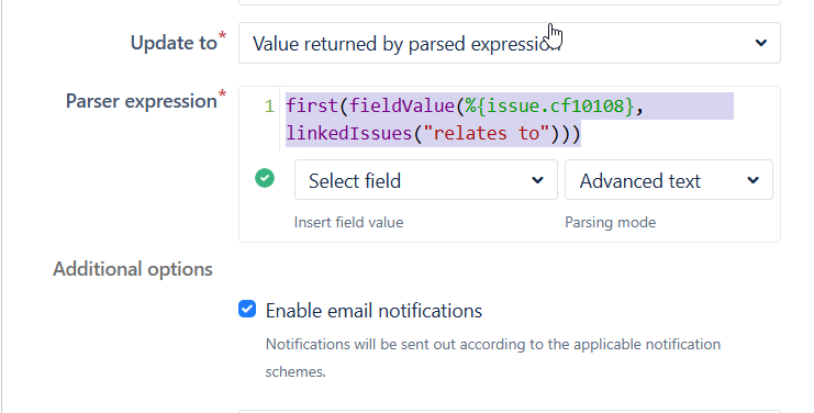

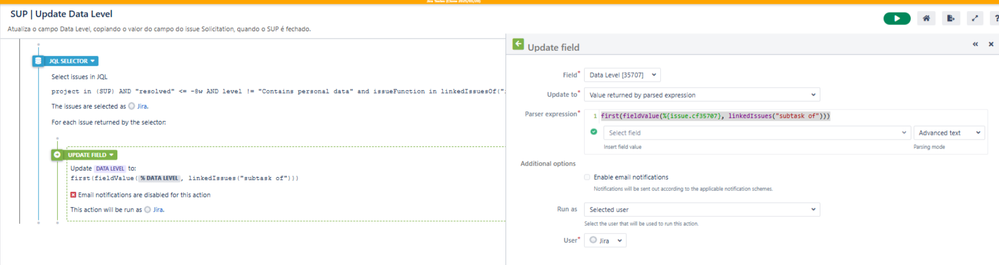

When you select the "Parent" value for a specific custom field, you are referring to the parent of a sub-task. In this case, you are using the link type "parent of", which is not a hierarchy between a sub-task and the parent, as you can find int the "What is the context" section of our Field codes page from our documentation: https://apps.decadis.net/display/JWTSDC/Field+codes
However, you can still achieve your current requirement using the following expression in "Advanced text" mode for your Update field action in your Automation Rule:
first(fieldValue(%{issue.cfNNNNN}, linkedIssues("link type")))
Just replace "NNNNN" for your "Data" custom field code. And "Link type" for your link type name. I saw in the screenshots that you use in the parent the link type "parent of". So instead, you should use the link name which appears in the "child" issues that have this linktype.
This is an example of how the "Update field" action looks in my instance:
In my case, my custom field code is "10108". As mentioned, the parsing mode is "Advanced mode"
In case you have any other doubt or if it doesn't work as expected, please let us know. I will gladly assist you :)

Hello @Sergio García-Consuegra _Decadis AG_ ,
Good news, my situation is resolved.
Many thanks for your awesome support
Is solved.
first(fieldValue(%{issue.cf35707}, linkedIssues("subtask of")))
