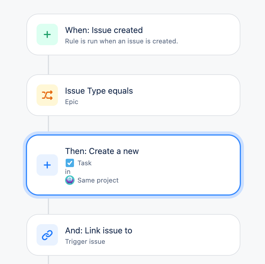

Thanks Bill. Sub-task is just an example, my main issue is more on the automation rule with the "Trigger issue" not working as expected.
Let me re-phrase it then using Task. Basically, when creating an Epic, I would like to automatically generate a Task template so users/teams would use that as a reference in creating their own tasks as usually there are no standards.
When: Issue created
If: Issue Type equals Epic
Then: Create a new Task
And: Link issue to Trigger issue
Expected results:
I create a new Epic called PROJ-1, then a Task would automatically be created too called PROJ-2. Lastly, I would expect PROJ-1 be linked to PROJ-2.
The last part is not working. However, when I use "Most recently created issue" instead of "Trigger issue" then it works.

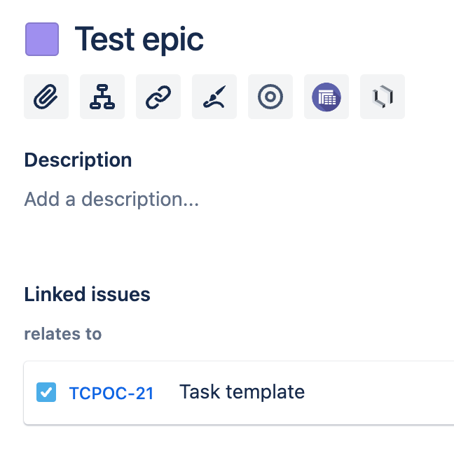

Expected behaviour but the "Linked issues" part is not working when Trigger issue is used as a value:

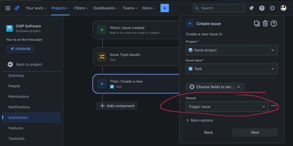

I expect you want to make the task's parent be the Epic rather than linking the task to the Epic. Is that not the desired result? Assuming it is desired here is an example.

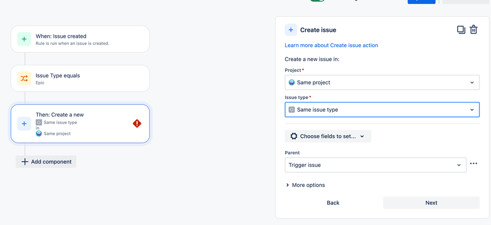

E R
February 12, 2024
This is gold, Jack. I am almost there but seems to have a bug in JIRA as it errors out doing this without any error details on the console.
`{"status_code":200,"errors":[]}`
Did it work from your end after hitting "Next"?
Jack Brickey
February 13, 2024
You chose "same issue type" in the Create issue action component which would equate to an Epic which can't have an Epic as a parent. Please change to Task or Story.
