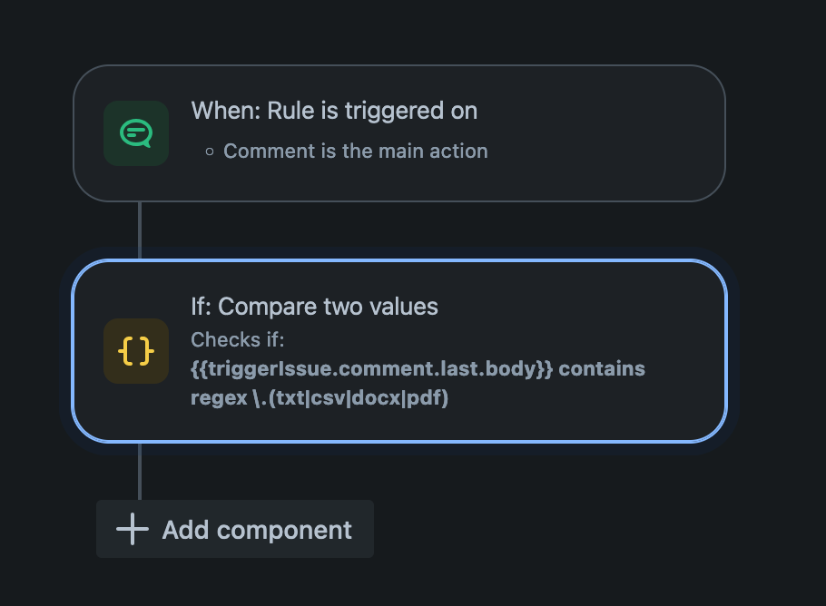

FF
December 19, 2024
After some trial and error, I've found that the following automation structure seems to achieve the goal of detecting if an attachment is contained within a comment. The only caveat is the "regular expression" portion of the condition must include the attached filetype in the regex query, otherwise the automation fails to trigger.
Trigger:
  • issue commented
    • Comment is the main action
Condition:
  • {{smart values}} condition
    • First value: {{triggerIssue.comment.last.body}}
    • Condition: Contains Regular Expression
    • Regular Expression: \.(fileType1|fileType2|fileType3|etc)

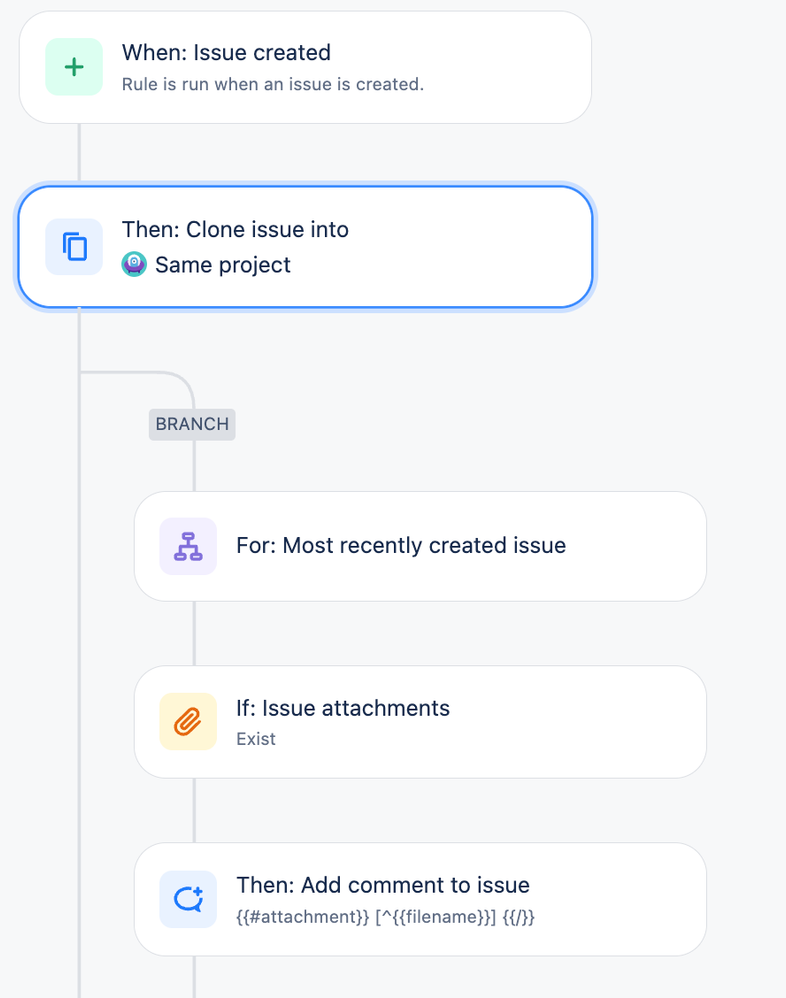

Breanna Byron
March 25, 2025
I had the same use case and found a decent work around.
Trigger: Issue created
Then: Clone Issue (make sure to copy attachments to the new issue)
 Branch for most recently created issue
If: Issue attachments exist
Then Add comment to issue : {{#attachment}}
[^{{filename}}]
Make sure to have the comment visibility be Share with customerScreenshot 2025-03-25 at 10.47.21 AM.png
