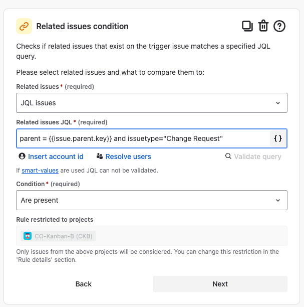

Next you said you want to have this affect only the children of Change Requests, not the children of Epics.
Add another Related Issues Condition, but this time choose JQL and set it thus:
This will confirm that the parent of the trigger issue is a Change Request.
