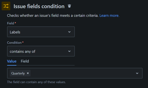

For Quarterly, I tried an Advance Compare Condition, but the automation did not consider the comparison of the task's {{issue.actualstart.plusMonths(3)}} - equal to the value {{now.jiraDate}} when I had set the task's "Actual Start" value to November 1, hoping the automation would trigger today, February 1.
The same automation rule failed for Bi-Yearly and Yearly when "Actual Start" was set to 6 months and one year prior, respectively.
I've attached the branch for Quarterly, hoping that if I can get a solution for that, I'll be able to modify the solution to work for the other Label values and Date Comparisons.Quarterly Cloning Automation FEB 1 23.png

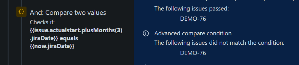

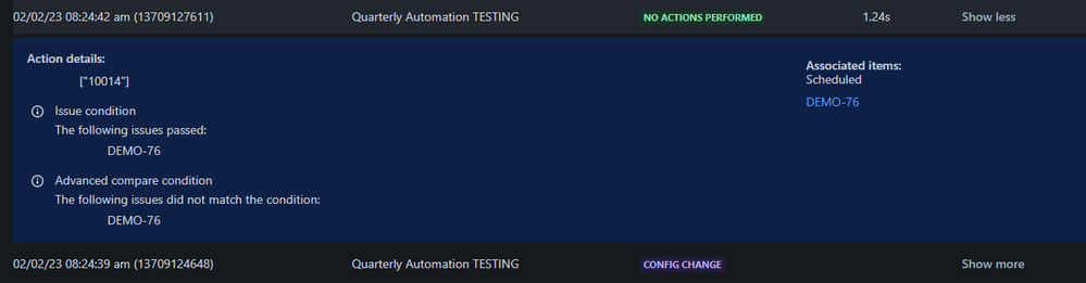

That was a fine suggestion. I tested it and the Advanced Compare Condition maintains that a story with the Actual Date "Nov 1, 2023" being 3 months before Today doesn't match the condition.
Image: left side shows rule; right side show automation declaring it isn't a match for the condition.

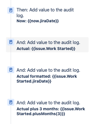

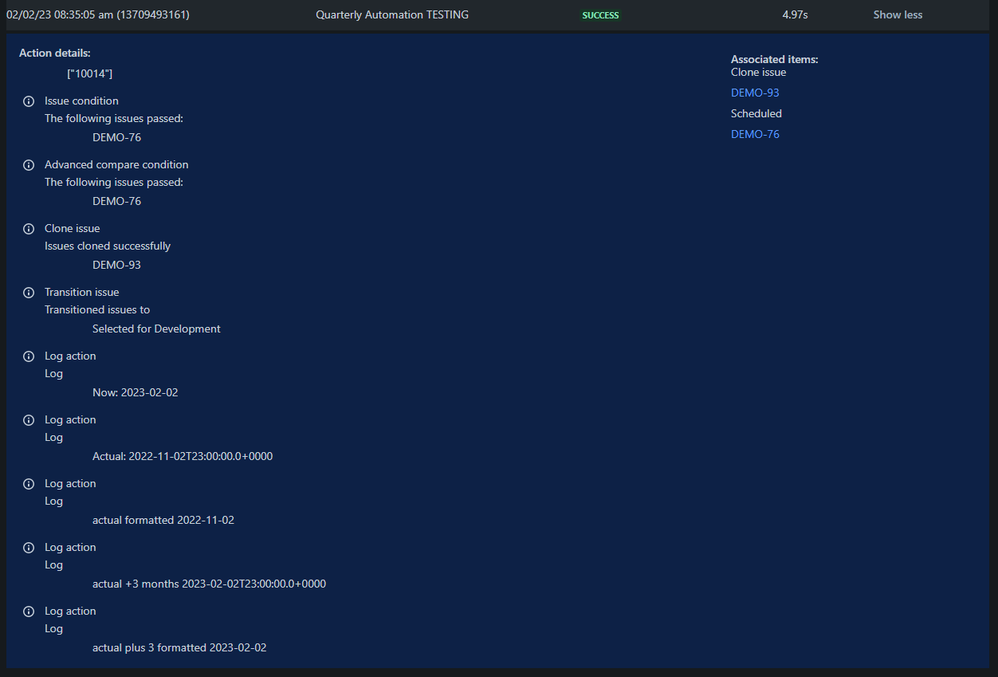

Could you please add Log actions to your rule to Log the values as follows? Substitute your field name where I have "Work Started". Then show us the log file results from trying to run the rule.

Yes, the field type is "Date Time Picker". This is a company managed project.
Attached is an image of the Actual start field with values "Nov 2, 2022, 4:00pm"

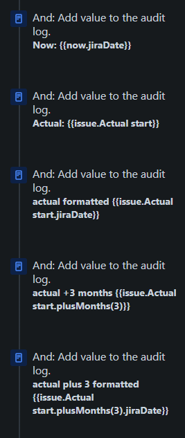

initially, I added your rules to my automation, but no actions were logged in the audit. log.feb 2 pic 1.PNGfeb 2 pic 2.PNGfeb 2 pic 3.PNG
but THEN I noticed your field "Work Started" had a space in it and my field was "actualstart" when it needed to be "Actual start".
So I changed the value in my Advanced Compare and this happened.

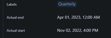

It took me a while to compile the information. After doing some testing, I think the issue might be rooted in how the 'Actual start' field is configured to set time. here's the rehash:

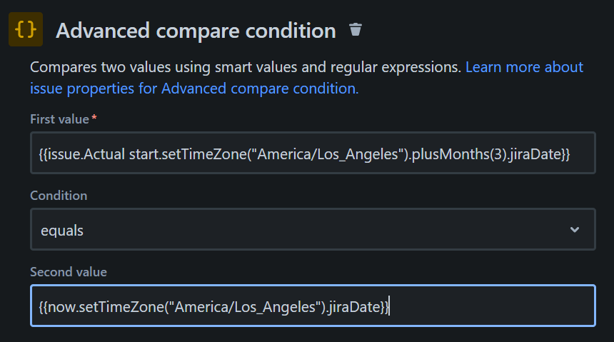

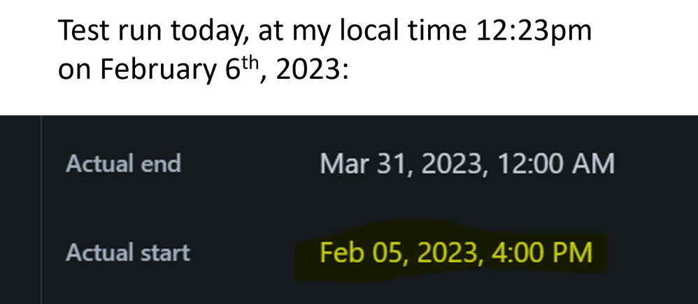

When the rule triggers, it changes the Issue’s “Actual start” value to the day before at  4PM and the Clone’s “Actual start” value to the day before at 4pm. Using a .plusDays1 statement in the JQL doesn't seem to set the dates correctly.

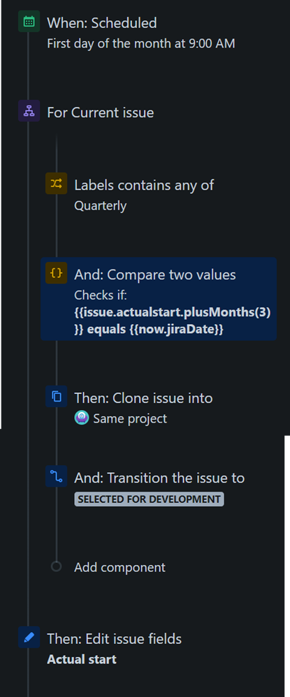

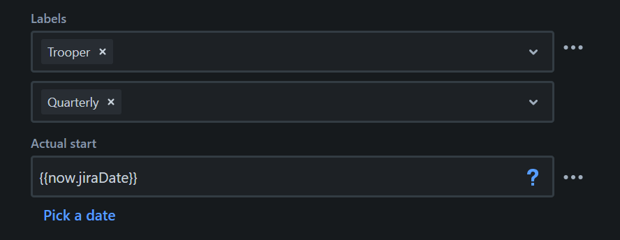

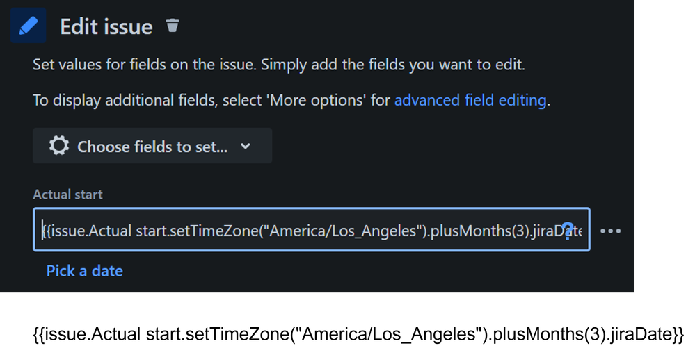

Note that in the rule above, for the Issue 'Actual start', I'm using the extended string to set the date to whatever it was +3 months, whereas on the Clone, I'm simply using 'now.jiraDate' to set that field. In both cases, the date is set to the day before 'Now' at 4pm.

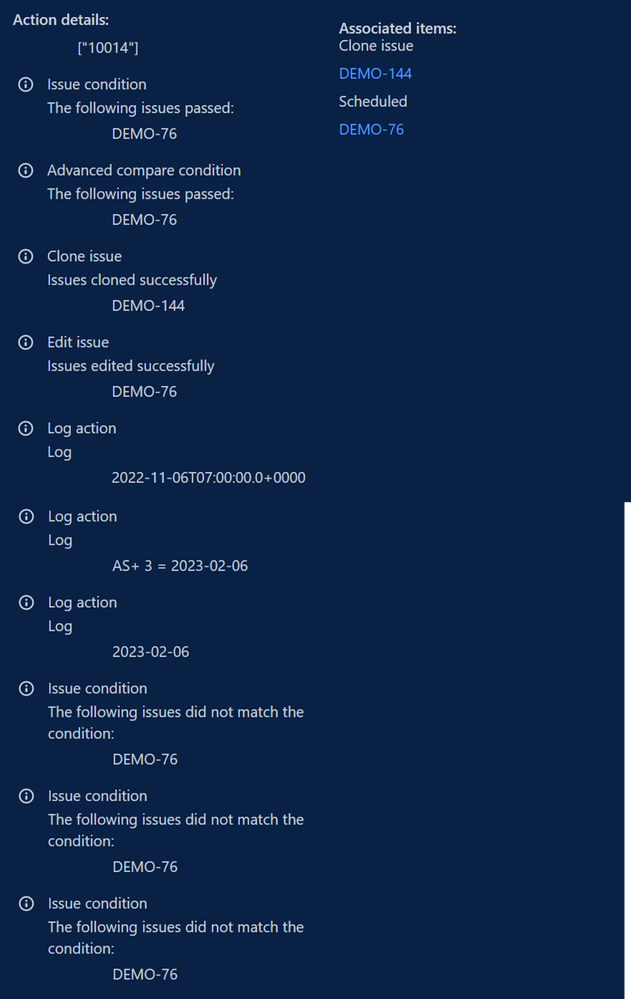

The Audit log:
For the log actions, I'm just trying to make sure the JQL resolves correctly. Seeing Feb 6th as the correct date in the log, I'm confused why the dates populate to the day before in the Issue and its clone.
Trudy P Claspill
February 6, 2023
What are you logging in those three Log actions?
I am guessing that the reason you see the field being set to the previous day at 4 pm would have to do with the use of UTC to record date/time values in the DB, and your personal setting for timezone preference.
The database stores dates and time in UTC.
The UI will automatically convert date/time fields to your time zone preferences when you are viewing the data.
When the rule sets the field to Feb. 6, 2023 with no time then 12:00 am gets set as the time. Feb. 6, 2023 12:00 am gets stored in the database.
When you view that in the UI, your timezone preference for Los Angeles converts that to Feb. 5, 2023 at 4 pm.

Follow up. by using .jiraDateTime, I'm now able to correctly calculate the "Actual start" and "Actual end" dates for the Issue and its clones. I'm still exploring ways to make the advanced compare succeed no matter when it is tested.

I have observed time zone impacting date/time operations for Jira automation rules...even when all participants are in the same zone.  Perhaps try forcing the values (actualstart and now) to the same zone before incrementing, formatting, and comparing.

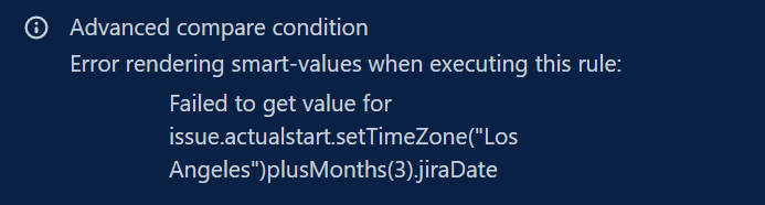

I augmented the statement to set a time zone, and the automation was unable to render a value. Perhaps my smart value statement is overcomplication?

It seems to be missing the period between the time zone change and the plusMonths().

Hi @Jason Weddell  - it needs an underbar - you can follow this format:
{{now.convertToTimeZone("America/New_York").mediumDateTime}}
