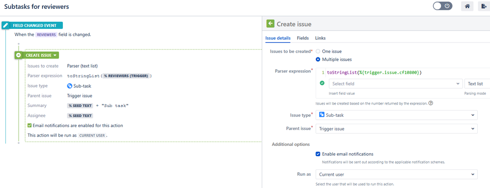

Nacho Moreno Ortega
November 27, 2025
Hi @Helen ,
I am Nacho and i am part of Decadis.
You can achieve the desired behavior by using our app Jira Workflow Toolbox as mentioned by Christos.
To do so, a JWT automation rule can be created with the following configuration:
img1.pngExpression from the issue details in which "NNNNN" must be modified for the id of the Reviewers custom field.
toStringList(%{trigger.issue.cfNNNNN})
You can easily decide when these subtasks will be created, for example when a field is updated or a transition is completed.
It is also possible to add a condition or validator to restrict the issue creation depending on your needs.
If you need any kind of assistance in the creation, please do not hesitate to contact us via our Support portal .

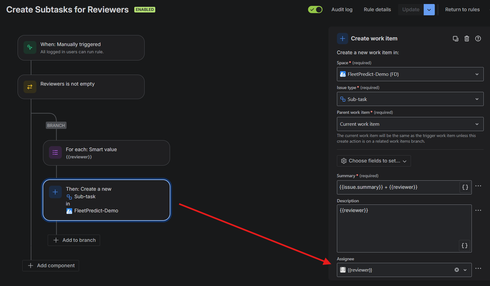

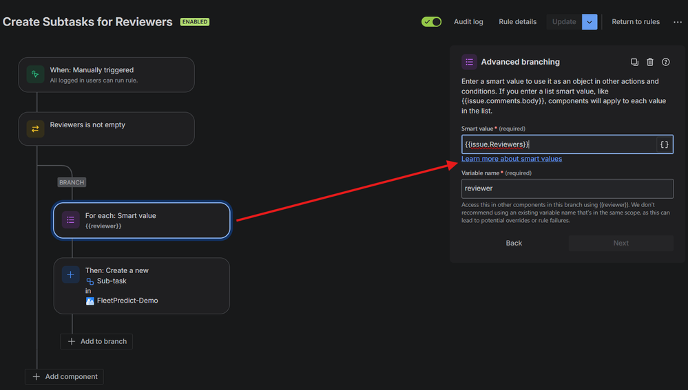

Christos Markoulatos -Relational-
November 26, 2025
Hi @Helen
it should work on DC also. just copy the smart value to the assignee
Screenshot 2025-11-27 091142.pngScreenshot 2025-11-27 091210.pngScreenshot 2025-11-27 091846.png
