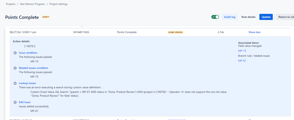

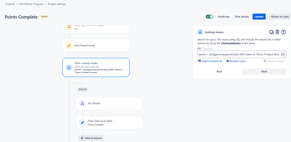

I edited to the following
parent = {{triggerIssue.parent.key}} AND status in "Done, Product Review"
And it failed.
Screenshots attached (including the Audit Log)

Figured it out.  It was successful using the following:
parent = {{triggerIssue.parent.key}} AND status in ('Done', 'Product Review')
Trudy Claspill
June 27, 2024
Your JQL syntax is incorrect. The comma separated list of Status values needs to be enclosed in parentheses.
parent = {{triggerIssue.parent.key}} AND status in ("Done, Product Review")
