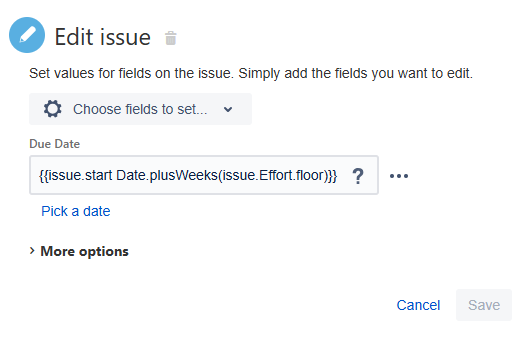

I tested this in a DC and found out that values of numbers fields are stored/returned as float/with digit:
see my example- the field "Effort" is a customfield of type Number and filled with value "3"
so the following line:
weeks: {{issue.Effort}}
returns into:
weeks: 3.0
Therefore the calculation with only using the numbers value in .plusWeeks() failed too.
Nevertheless this can be solved with using the "floor" function to numbers. So the following line in the "Edit issue" action worked for me and the Due Date was updated correctly (replace the "Effort" with your specific customfield´s name):
{{issue.start Date.plusWeeks(issue.Effort.floor)}}
Please let me know if this helps.
