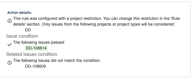

@Ron can you please paste a screenshot of the rule log?
Ron
July 7, 2022
Alex Koxaras -Relational-
July 7, 2022
@Ron you are not getting any error with this rule. The passage you copied/pasted is an informative one, hence the "i" next to it.
Your rule runs smooth. However the linked issues didn't match the conditions you specified. That's why no actions were taken:
All link types must be equal to a certain issue type (end user deletion).
Are they all the same?
Ron
July 10, 2022
I need to change all linked issues of type 'End User Deletion'.
Currently I have one linked issue of this type and the condition fails

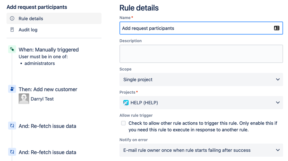

You can also look in the Rule details section to edit the the scope of your rule:
