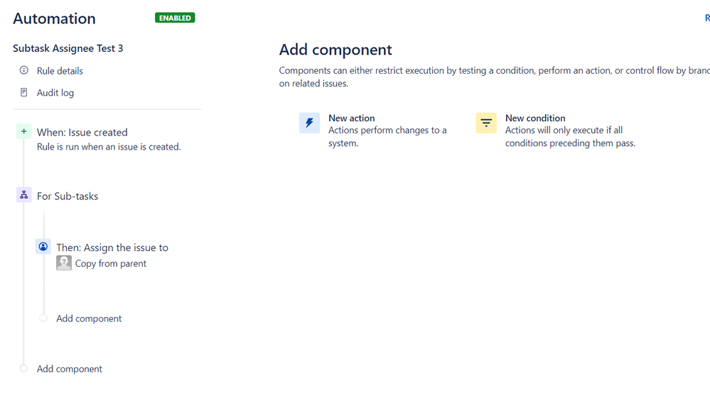

I have the following requirement:
On subtask creation can we default the assignee to the creator of the subtask.
I setup a automation rule on this project:
I have tried everything but my sub task is not updating with the creator when it is created.
Please could you assist?

just for a better understanding on my side. From opening post you I seem to have understood by creating a sub-task you want to set assignee = reporter but your Automation rule seems to show you want to copy the assignee from parent issue.
Which route do you want to go and is one of it working - or are you still stuck with implementation?

Hi Vanessa,
Try this:
Change the branch to a simple Condition based on issue field. Use Issue Type = Sub-task
Then add a New Action for Edit Issue
Select Assignee, then click on Copy From Current Issue
Then click on the words Current Issue which will show a drop down.
Select to copy from the Reporter field.
Vanessa Becker
April 20, 2021
This is the rule that i have set up. What am i doing wrong?
