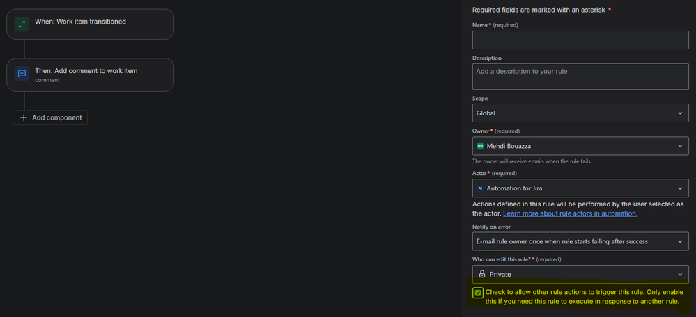

Is the transition from "To Do" to "In Progress" expected to be done manually, or through another automation?
I'm asking because there is an option that needs to be enabled if the automation trigger is initiated by another automation.
