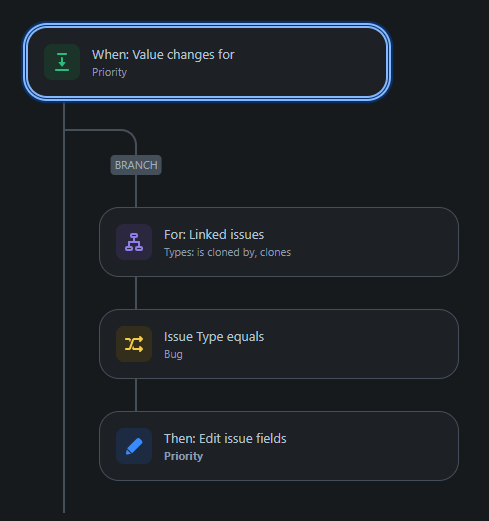

Hello,
Can someone help me understand if the rule i have created is incorrect or its automation nodes getting failed and because of which the rule is not getting triggered.
Below is my rule and i want to update priority for issue type "Bug" between Jira Software Project & Jira Service Management Project and they are both linked by following types : cloned by and clones.
But when i update the value of priority in Jira Software Project it is not updating the value in Jira Service Management Project for the issue type Bug and also there is no log generating which can tell me if my rule was failed or incorrect.

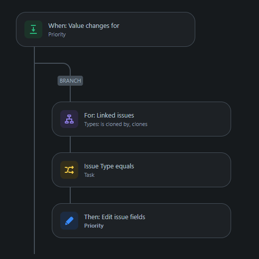

Here is the rule i created for Issue type "Task" with same logics and conditions and its working fine.

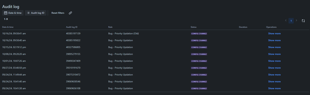

danish.khatri
October 24, 2024
I initially created this rule and when it was not working so my Jira admin suggested since they couldn't check the automation nodes instead asked me to recreate the rule here is the audit logs for both the times i have created the rule for
1st first time when i created the rule then turned off and created new rule

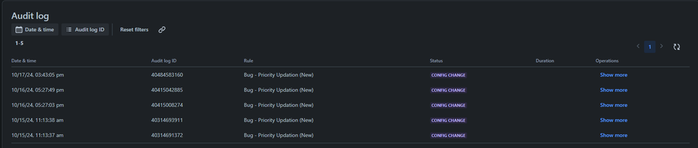

New rule audit log

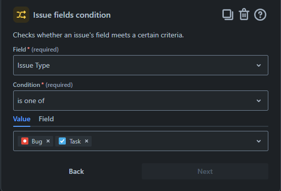

danish.khatri
October 24, 2024
I am thinking of merging the Task & Bug Priority rule together and hoping it should work.
I just have to update the rule condition logic as below
