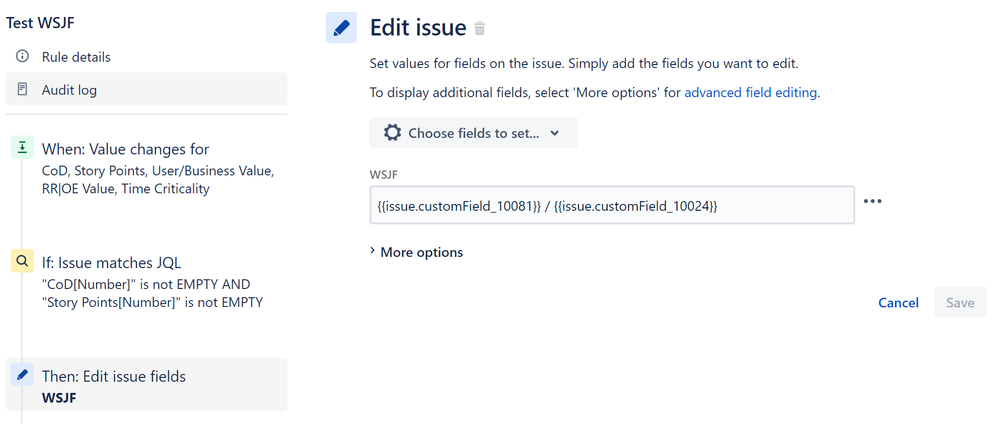

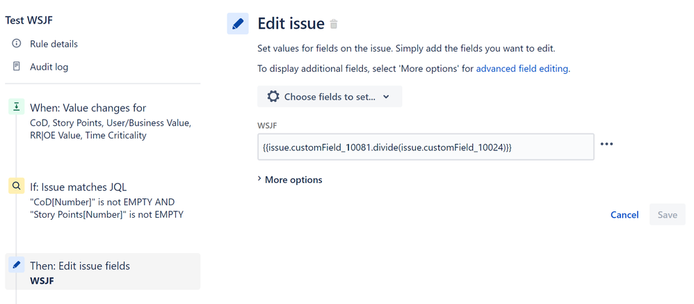

I'm trying to set up an automation rule which divides one field by another and populates a third field with the result.  It's failing, saying that the first field isn't numerical 'CoD - 10081'.
4 answers
2 accepted
4 votes
Bill Sheboy
July 6, 2021
Hi @Lucy Cookney
To perform that math operation on your CoD (Cost of Delay) to determine WSJF (weighted shortest job first), you need to use math operators:
{{#=}}{{issue.customField_10081}} / {{issue.customField_10024}}{{/}}
or
{{issue.customField_10081.divide(issue.customField_10024)}}

The second option appears to be accepted...but it's not populating the WSJF field.
I have the success message:
But the field is blank:
Thanks
Lucy

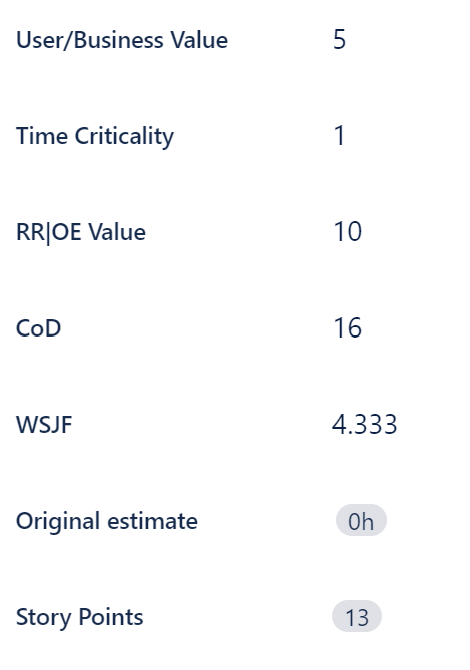

Oh that's strange, I've switched the numbers around to:
{{issue.customField_10024.divide(issue.customField_10081)}}
It's populating the field but with the incorrect answer:

Ah thank you so much for the help...I've figured out why it wasn't working....
So I have a calculated field in CoD - it updates when I amend User/Business Value, Time Criticality, and RR|OE Value and adds them all together.
So my calculation for the WSJF field was updating as soon as I updated one of those and it was using the old value in CoD (silly me).
However, now I have changed it to make sure it only updates when either CoD or Story Points is updated - it doesn't recognise CoD being updated as it's being done by another automation rule.  I'm guessing it must be a limitation so might need to schedule it to run periodically šŸ¤”

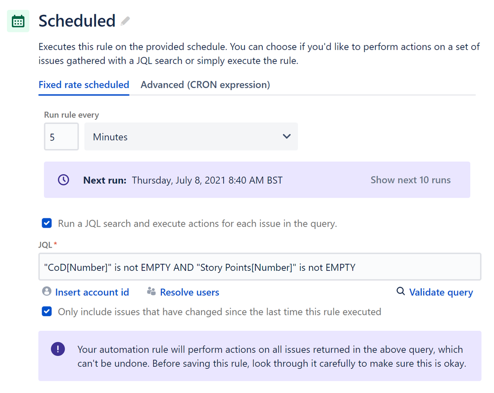

Lucy Cookney
July 8, 2021
Thank you everyone for the help.  I have now amended my rule to the below.  Feel free to suggest anything better but this appears to work 😁

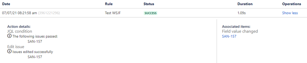

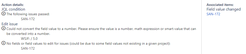

I was getting this error message:
However, I am now using the expression:
This is showing as successful but the WSFJ field isn't populating:
Thanks
Lucy

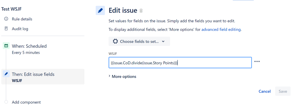

When I look at the error, it mentions the value it is trying to get for WSJF is /5.0
which seems to suggest that you are trying to divide by the Time Critically field since it has a value of 5. So if that field is wrong, I am suspicion that you are not using the right field for the first number either.
So I would just use the field name and see what happens. Try it with this:
{{issue.CoD.divide(issue.Story Points)}}
Like • Lucy Cookney likes this
Lucy Cookney
July 8, 2021
Thanks so much for your help, I didn't know I could use the custom fields names!  I was definitely using the wrong ID in my original calculation as it is now "working" but with a limitation that I assume isn't something I can do anything about.
