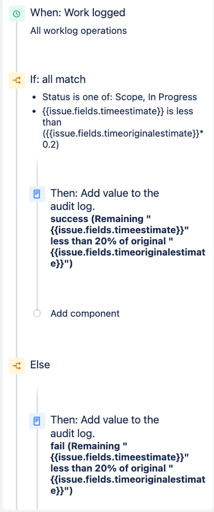

Hi @Bill Sheboy ,
I'm trying to set up a similar automation (just 20% instead of the 30% mentioned above). Hopefully, you can help me.
Background: When 80% of the time has been spent (=less than 20% left) I want the automation to send an email.

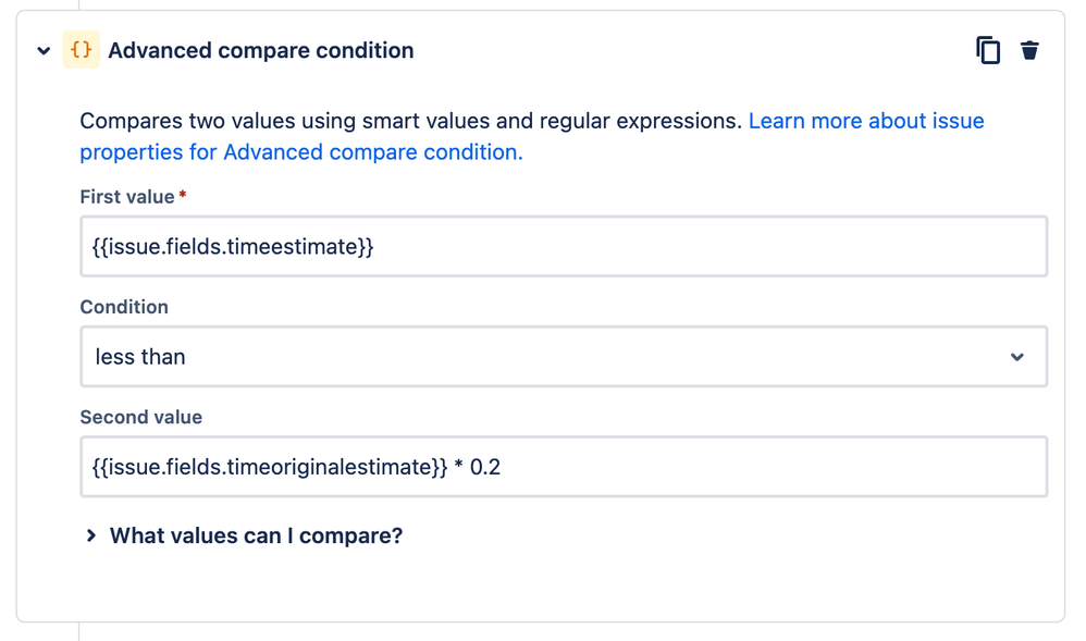

I was hoping that I could use the Advanced Compare Condition but what I've tried doesn't work and I couldn't find any documentation on how to get "20% of the Original estimate". See my screenshot below for what I've tried.
To check it, I set up two Log Actions:
1) If condition matches:
"success (Remaining "{{issue.fields.timeestimate}}" less than 20% of original "{{issue.fields.timeoriginalestimate}}")"
2) Else:
fail (Remaining "{{issue.fields.timeestimate}}" less than 20% of original "{{issue.fields.timeoriginalestimate}}")

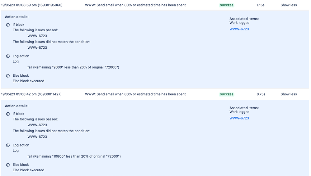

As you can see in the Audit log, it always shows the Else message (fail) although the Time remaining is less than 20% of the Original estimate.
I think my mistake is with the Second value of the Advanced compare condition but don't know how to change it.
Any help greatly appreciated.

Thanks for that information. The problem is how you are performing the math operation. The way you are doing it is leading to a text string and not a number.
There are two ways to perform math operations in rules: inline and using a math expression:
{{issue.fields.timeoriginalestimate.multiply(0.2)}}or
{{#=}}{{issue.fields.timeoriginalestimate}}*0.2{{/}}Please replace the second part of your advanced compare condition with one of these to see how that helps.
