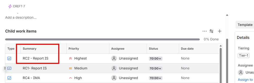

The assessment takes 180 days in total. Each task has a fix SLO. Picture 1 is a screenshot of the first 3 tasks ( there are about 16 tasks)

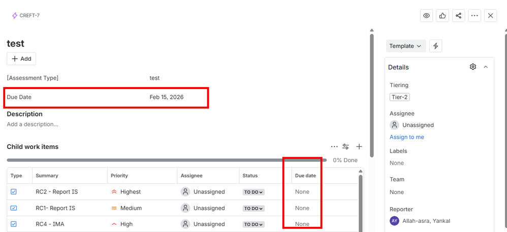

Looking Picture 1 , the first task RC2 - Report IS has a max SLO of 90 days. If the assessment due date is Feb 15,2026 - I would like to Due Date for RC2 to auto-populate to  November 17, 2025 as soon as the Feb 15 date is entered.
The RC1-Report IS task has a max SLO of 100 days - so its due date should auto-populate to November 27, 2025
The RC4- IMA with a max SLO of 120 days , should have a due date of December 17,2025.

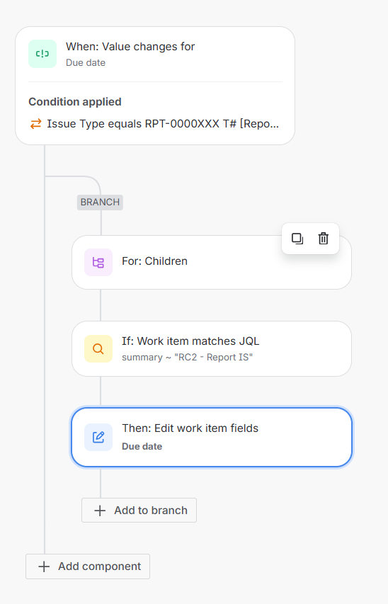

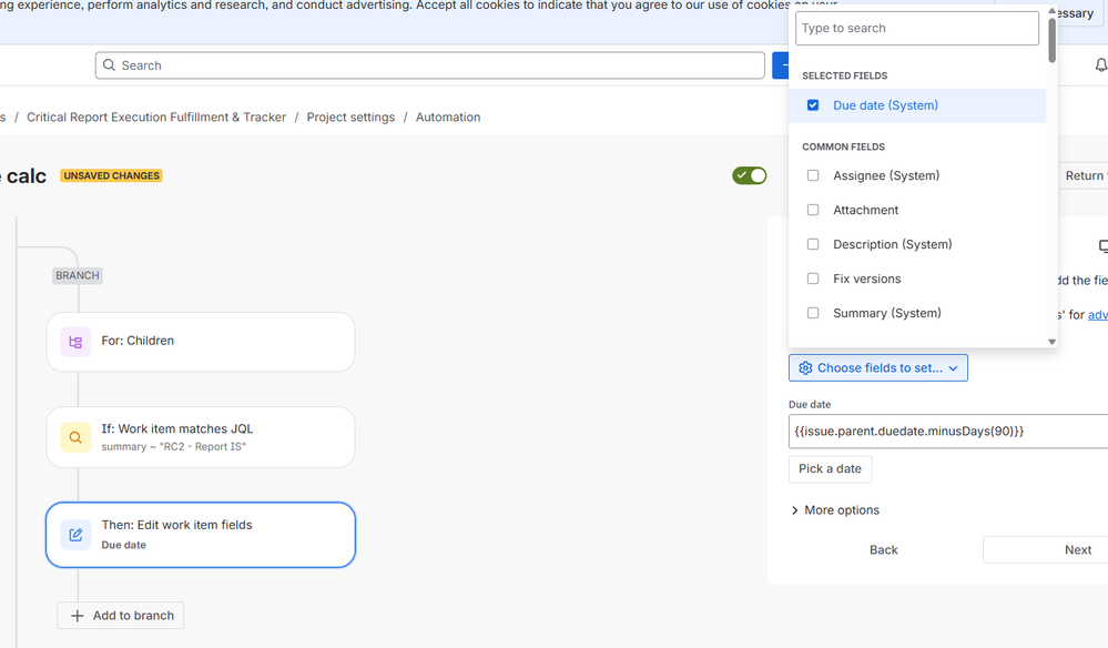

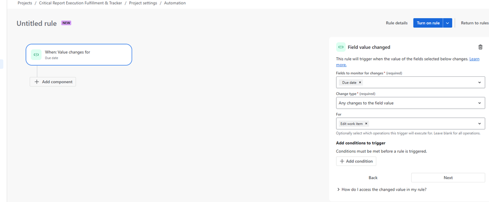

@Bill Sheboy  thank you! Here's what I have come up with based on the info you have provided but it the rule does not seem to be running (after checking the audit log).
Here's the reasoning I am trying to establish: when the Epic due date value change, look for  work item that has 'RC2 - Report IS' as summary , and apply the following {{issue.parent.duedate.minusDays(90)}}pic4.pngpic3.pngpic2.pngpic1.png

Please post an image of the audit log details showing the rule execution.  That will help identify why the update did not happen as expected.

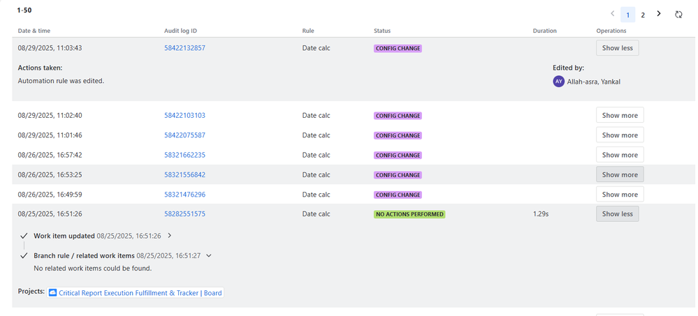

Bill Sheboy
August 29, 2025
@Allah-asra, Yankal  -- For the log you show, the branch found no child work items.  Was that expected for that trigger work item?
And...are the child work items in the same project as the Epic?
When they are in different projects, the rule scope (in the details at the top) needs to change for the rule to access them.  Your Jira Site / Product Admin will need to help make that change in the global automation settings area.
Allah-asra, Yankal
August 29, 2025
Yes the child work items are in the same project as the Epic.
The expectation is for the rule to be executed for the child work items when the date field is entered at the epic level
Bill Sheboy
August 29, 2025

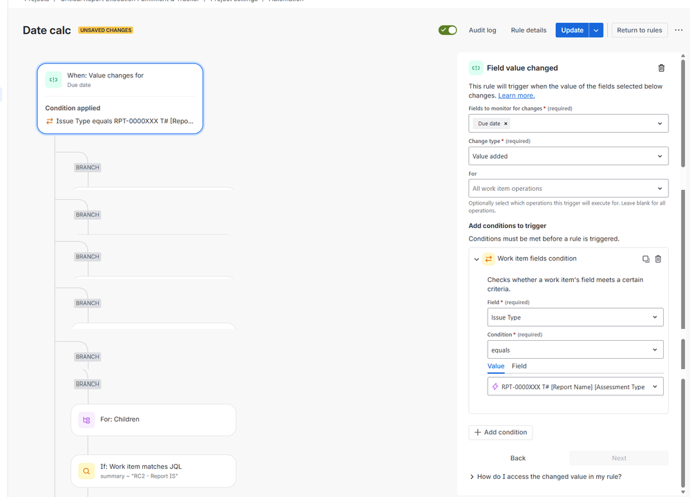

For the audit log you showed when the rule ran, please expand all of the areas with the > indicators to show which work item triggered the rule.
There is also another possibility: the feature to add conditions to triggers is quite new, and there have been several reported defects.  You could remove the condition from the trigger and add it as a separate condition immediately after the trigger.  That will help confirm my above hypothesis: the rule is running for a different work item than you expected.
