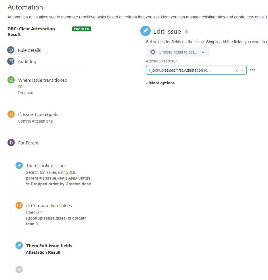

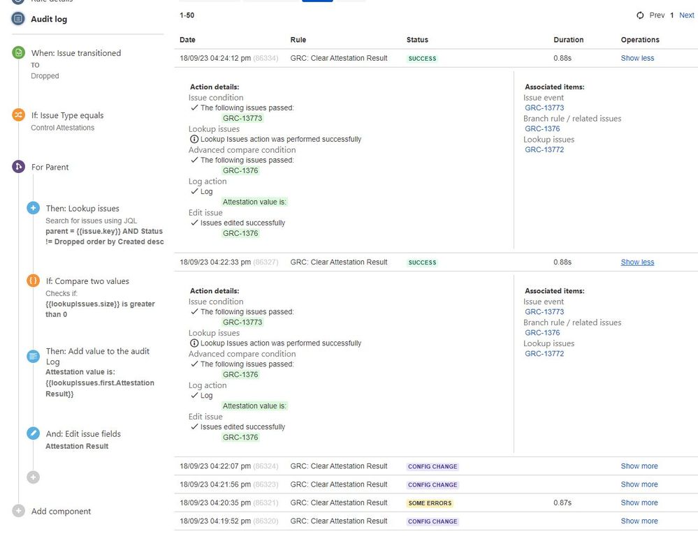

@Trudy P Claspill I think your suggestion is on the right track.  I have created an automation rule as you suggested using lookupissues, the rule runs and says success but the "result" field at the parent level gets cleared after I transition the sub task to drop rather than taking the last sub tasks "result" value.
Trudy P Claspill
September 18, 2023
Can you show us the rule you constructed and the Audit Log for the rule execution?

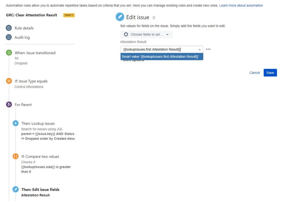

Would you also please show an image of the details of the Edit Issue Fields action?
Trudy P Claspill
September 18, 2023
Can you show us the full smart value you are using to set the field?
Did issue 13772 have a value for Attestation Result?
Could there be subtask that don't have a value for that field? If the field has no value, do you still want the parent issue field set to match? Or do you want the parent field set to match for the latest subtask that does have a value?
Like Bill Sheboy likes this
Nadeem Zakir
September 18, 2023
Hi @Trudy P Claspill @Bill Sheboy  thanks both for helping out.  The field Attestation result is always populated on the sub task and the parent.  It copies from the sub task to the parent.  Have attached more images.
attestation result edit.JPGattestation result parent.JPGattestation result smart value.JPG

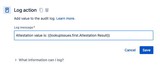

Can you add a Log action after the condition where you check the lookupIssues.size result, and print to the Audit Log the value in the smart value you are using - {{lookupIssues.first.Attestation Result}}
Then trigger the rule agains and show us the Audit Log again?

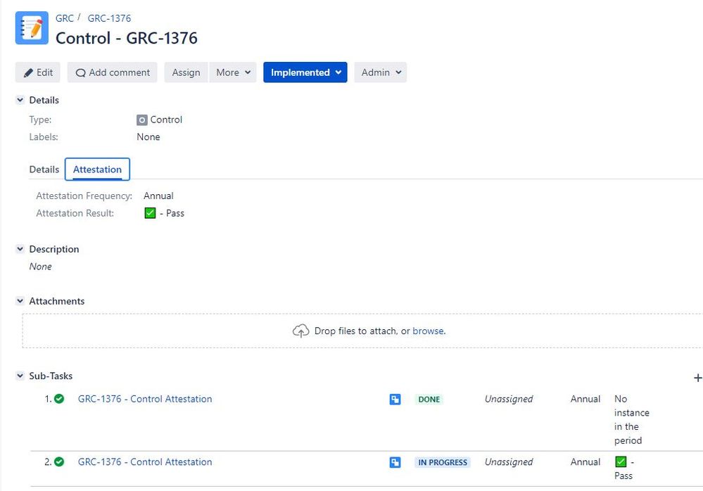

Nadeem Zakir
September 18, 2023
if you look at the Control issue, which is the parent. That has two sub-tasks, one is done and one is in progress. Both those sub tasks have an attestation result, “no instance in the period” and “pass” respectively. Sometimes, we need to transition a sub-task to Dropped, in this case, lets say the sub task that has passed.
What we are trying to achieve then, is for the attestation result to be taken from the other sub-task with the value “no instance in the period” and have that copied over to the attestation result field on the parent. Its the same field for both sub task and parent, under the attestation tab.
How do we determine what sub task to use? We use the sub task that was created last, using the created date. So we could end up with 8 sub tasks. created in order, 1,2,3,4,5,6,7 and 8. Sub task 8 gets dropped so the rule copies the attestation result of sub task 7 to the parent.

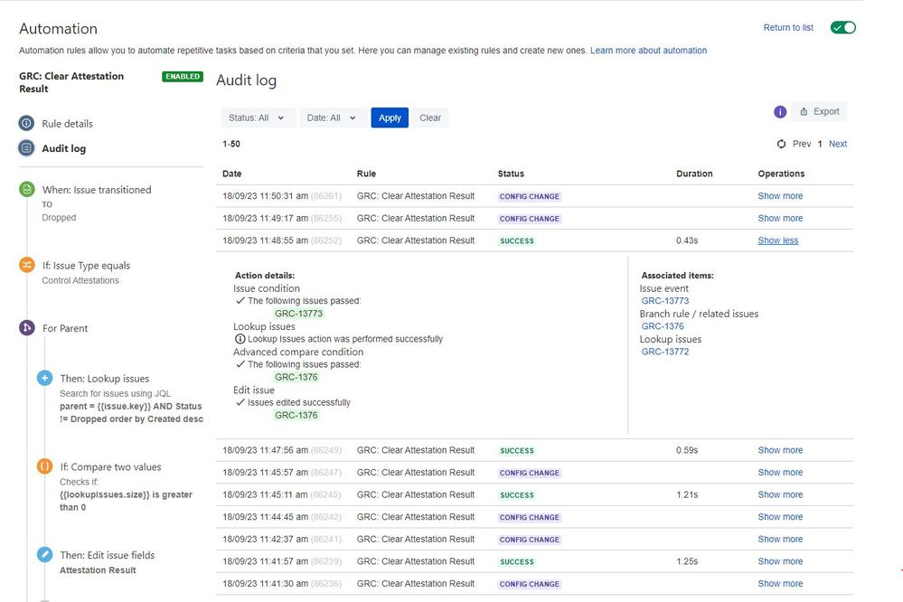

no errors in the log
Trudy P Claspill
September 18, 2023
The log is not printing a value for Attestation Result for issue 13772.
So, either the smart value being used is incorrect, or there is something about that type of field that requires the user of a different smart value.

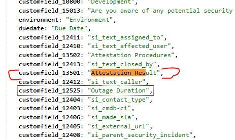

You can try using the custom field id instead:
{{lookupIssues.first.customfield_13501}}
Also, what type of field is Attestation Result?
Nadeem Zakir
September 18, 2023
Its a single choice select list, I have tried using the name and the ID of the field.  So still no luck.
