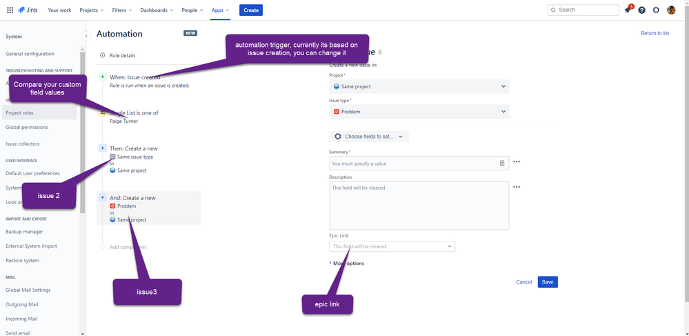

Welcome to Atlassian community. If I understood correctly, you want to create two more issues based on custom field values and associate them with epic.
Yes , it is possible, please have a look at attached screenshot. Please feel free to reply back if my assumption is wrong so can help you in better way.

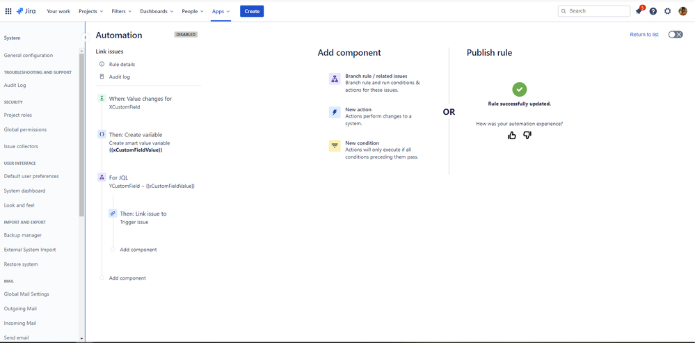

Muhammad Ramzan(Atlassian Certified Master)
January 18, 2021
I see, now its clear to me. Thanks for the clarification.
So you can't achieve it by above way.  Here is new way. Please have a look at attached screenshot.
What I did, I saved the triggering issue(epic) value in a variable and used that value to execute the JQL then linked the resulting issues with the triggered issue.

Javier Cárdaba
January 19, 2021
Dear Muhammad,
I have arrived to the solution you have summarized in your feedback, so... THANK YOU!
