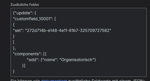

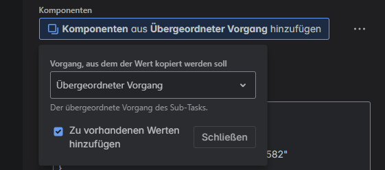

Hello everyone,
I ve got stuck with an Automation rule:
1. There is a manual trigger in an Epic which enables creation of multiple tasks.
2. Every single task should have the same components as the parent ID/Epic--> Copy from parent ID function provided by Jira.
3. But some tasks should have additional components.--> added a JSON in advanced options.
4.Result: the Parent ID component is displayed in the child task but not the additional component.
Could you pls help me with that.
Attached you ll find the way I tried to solve the issue.

Bill Sheboy
July 16, 2025
Hi @Antonina Yudina
In a single Create Work Item action, one cannot select both a specific field from the dropdown list and update it with JSON.  Usually, this leads to strange rule errors, although it could also create an unpredictable update.
The solution for your scenario is to first combine the Epic's values with the additional ones in a Created Variable, and then use that variable to dynamically build the JSON.  This approach allows handling edge cases, such as when the parent Epic has no values or duplicates the additional one.  (The duplicates may be removed using the list distinct function.)
Please let me know if you need help writing those rule actions.

Philipp Sendek (catworkx)
July 16, 2025
Hi @Antonina Yudina ,
I just tested this on a local test system and I would say your syntax is fine.
In my example I've used the following code to add a Component to the ones that were already on a work item:
"update": {
"components": [{
"add": {"name": "Test3"}
This leaves me with the suspicion that this could be a conflict in the action itself. I assume both of your screenshots are in the exact same Action in the Automation?
In this case, it could be that the advanced part of the action is run first (adding the component "Organisatorisch" and then the copy process is started afterwards which could replace the previous component.
The easiest way to test and fix this would be to have a second action element to apply the additional component.
I've also tested a bit with using one advanced element to add both the parent components and the additional component, but getting the JSON right with an iteration of the parent's components is quite challenging.
I hope that helps!
Greetings
Philipp
