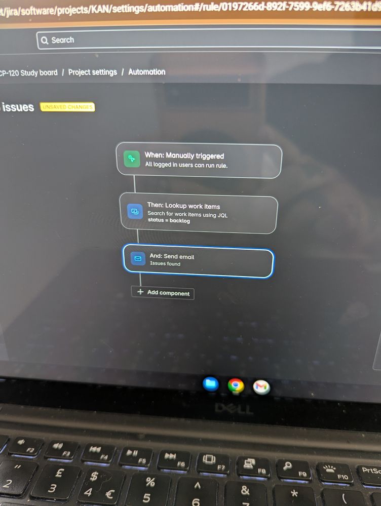

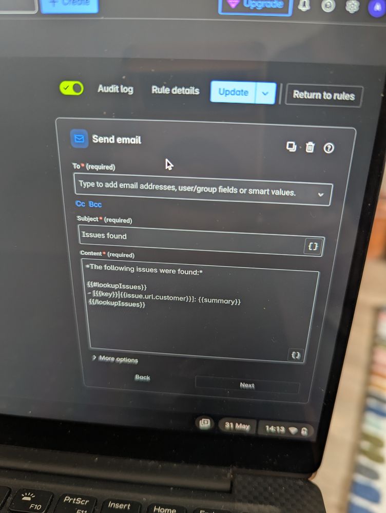

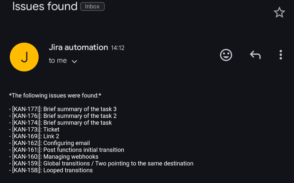

I think I've achieved what you need.
Using the issue lookup action and then the {{#lookupIssues}} smart value.
You can adapt the automation to fit your needs but as you can see from the output it does as you want.
Thanks
Aaron
