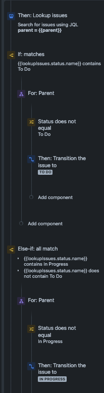

Mark Segall
October 13, 2023
Sorry for the delayed response.  If you're on cloud as this question is tagged, you should have the option.  Here's a snippet of the rule I created in my test environment:
