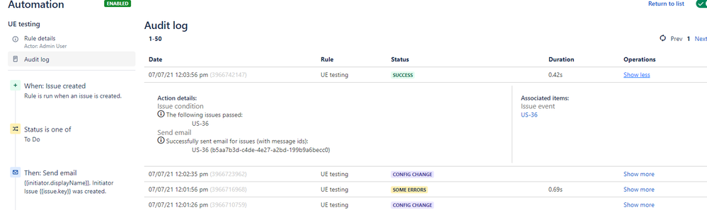

Configured an automation rule but audit log is only showing "CONFIG CHANGE"
The rule is not being triggered even though issues are being created.

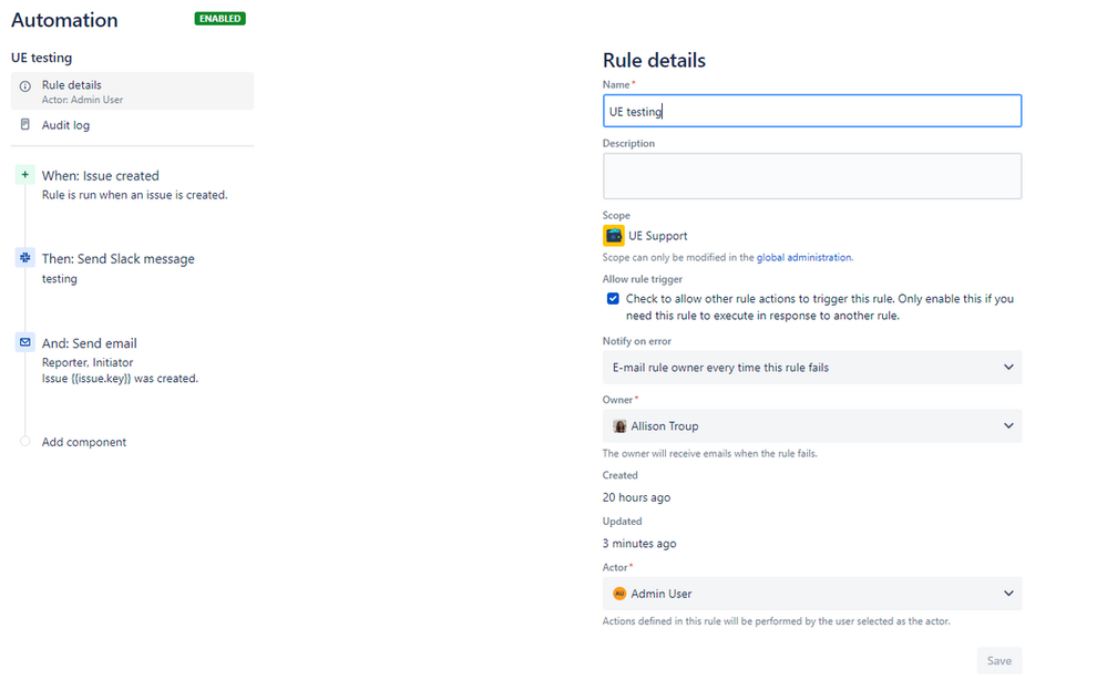

Here is a breakdown of the rule itself
Here are the rule details.

Is your initial status Open when a new issue is created? Normally when you create a rule when the issue is created you do not have to check the status as well.
Allison Troup
July 6, 2021
Correct, the initial status goes straight to Open. Even without that component it still didn't work.

Bill Sheboy
July 7, 2021
Hi @Allison Troup
Would you please post an image of the audit log for an execution where you think the rule should send an email?  That may provide more context so the community can offer ideas.  Thanks!

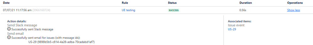

I added a webhook to my slack channel. It says it worked but I'm not seeing any emails. I did get the message in my slack channel though. I don't know where it's sending these emails.imageimage

Thanks!  How about this: change your rule to send the email only to yourself with a known good email address, and retest to see if that works.
If it does, that narrows this down to possibly invalid email addresses or the receivers consuming/or sending the emails to spam.
If it does not, there is a more general issue with emails not being sent, or a problem with the smart values used in the receiver address.
