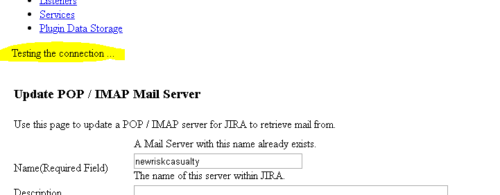

I thought of using below curl command to get the connection status and then use findstr to search for the string "The connection was successful."
curl -u test:test -d "@data.txt" -H "Content-Type: application/x-www-form-urlencoded" -X POST 'https://sswauat.catlin.com/secure/admin/VerifyPopServerConnection!update.jspa' > result.html
Usually checking connection would take 4-5secs to get the connection status but the above command finishes execution in 2 sec.So the html output says connection status as "Testing the connection ..."
I need to add a delay before curl redirects output to result.html so that connection testing is complete and html gets connection status as either "The connection was successful." or "Unfortunately no connection was possible."

I tried with below in the batch script but still facing same problem
@echo off
(curl -u username:password -d "@data.txt" -H "Content-Type: application/x-www-form-urlencoded" -k -X POST
"<base url>secure/admin/VerifyPopServerConnection!update.jspa"
Sleep 10 )> result.html

I tried with -m option earlier but it was of no use.
--connect-timeout also didnt help much as once curl has connected this option is of no more use but we want the delay after curl has connected and before curl gets disconnected
Is there a way to make curl wait for few secs before it can wait before it fetches the result from the website?
All the options we used till now doesnt actually lengthen the execution time of only curl.
