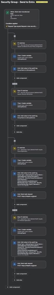

Hello, i am having some problems with my automation and variables and am looking for some help understanding why this isn't working.
The first step in my automation is to create the variable. The Variable is set based on a custom field using a series of if else statements. In this picture the custom field was Application, so the variable should be "APP-{{Application name}}" (Atlassian-Test-Jeremy). The if statement works to cerate the variable and then logs that.
The second step logs several pieces of information from the ticket that will be sent as part of a web request further down the automation.  In this step i try to pull the variable Group Name that was created in step 1, but it comes up blank.
I tried adding a delay before step 2 and that didn't seem to do anything.
Before you ask, the 2nd Create Variable seen here is creating a different variable. Its not overwriting the one from step 1.

Photo provided in reply to Tomislav.
I'm not using advanced components so i don't believe that should be the cause.
Unless each if-else string acts as its own block? that's what I'm confused about. I cant find anything documented saying that it does act on it own. But i also cant find anything saying it doesn't either.......

Please see the image i replied to Tomislav Tobijas with. It shows the full automation.
https://community.atlassian.com/forums/image/serverpage/image-id/417484i99D4C87E9ADC0DE9/image-size/large?v=v2&px=999
I do not have another work item field with the same name. When i save the variable to my log during step 1 it shows up correctly.  But when i got to write the same variable in step 2 it shows blank.

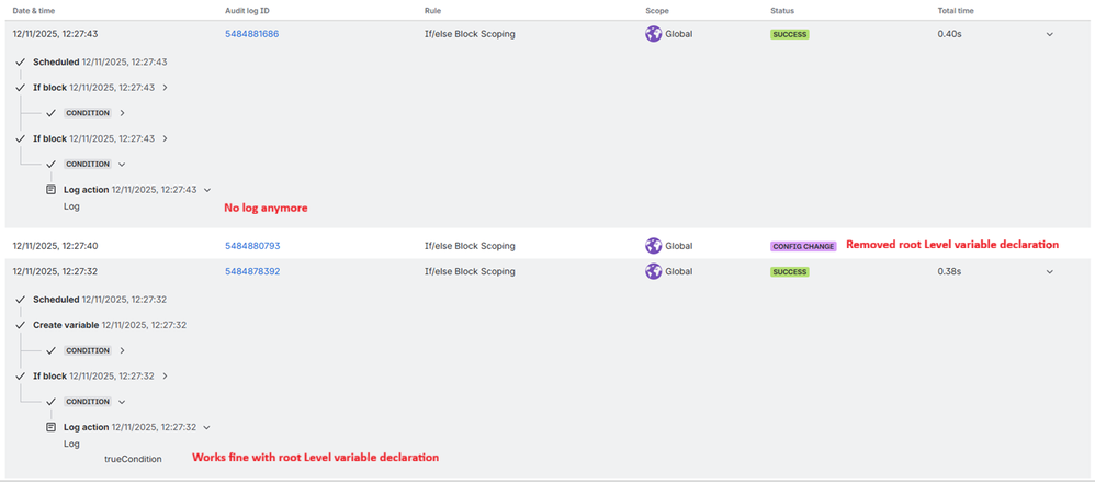

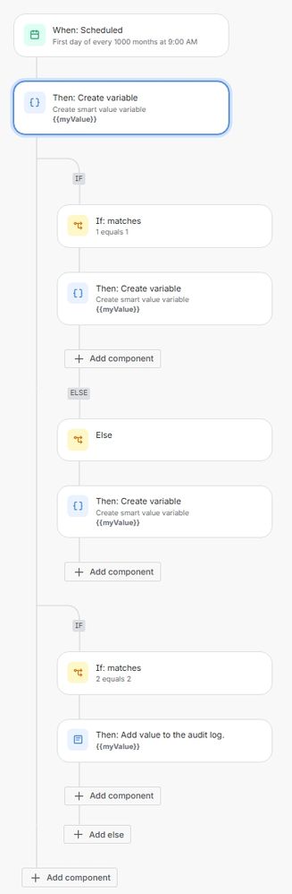

I can confirm @Bill Sheboy suspicion. I ran a little test with the variable created in the root cause and without it.
You setup:
  • Trigger
  • If
    • Create variable: GroupName
  • Else
  • If
    • Use variable:  GroupName
  • Else
-> The variable is not available within the second if/else section
Working setup:
  • Trigger
  • If
  • Else
  • If
  • Else
-> The variable is available within the second if/else section
See the screenshots for reference.

Here is the automation rule slimmed down. In the full version there are a couple more else if statements during the 1st part but that's really the only main difference.
Don't mind the Deleted field notations. I exported my automation to a different space and took this photo before also moving over the custom fields.
