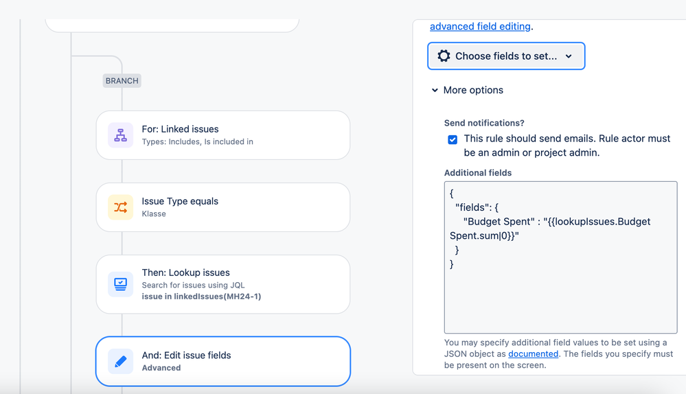

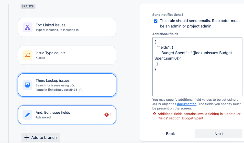

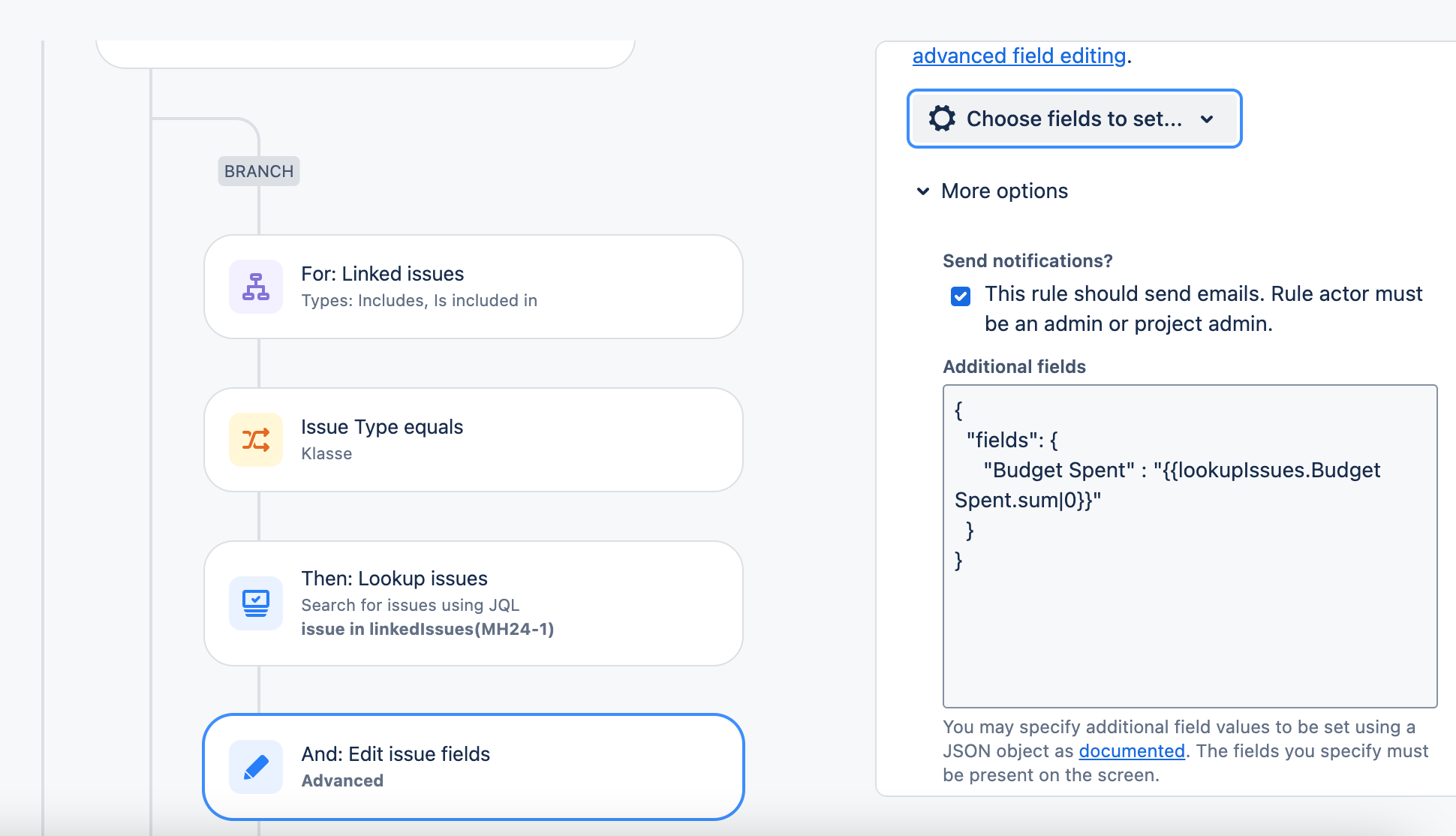

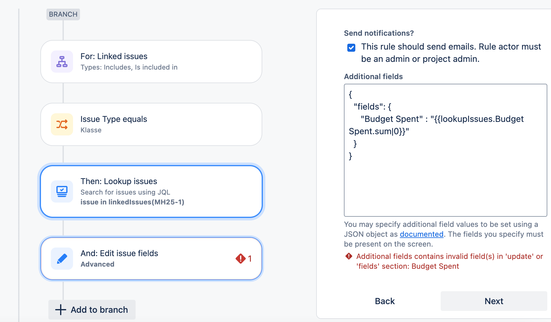

Attached are the
a) failing step upon the validation of the copy
b) source step working fine in the current '24 project
Any ideas?

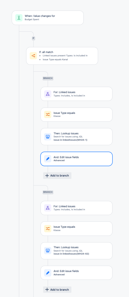

- the rule has got these branches in it, overall 8, with a difference only in the linked issue step, since it's very specific for each branch.

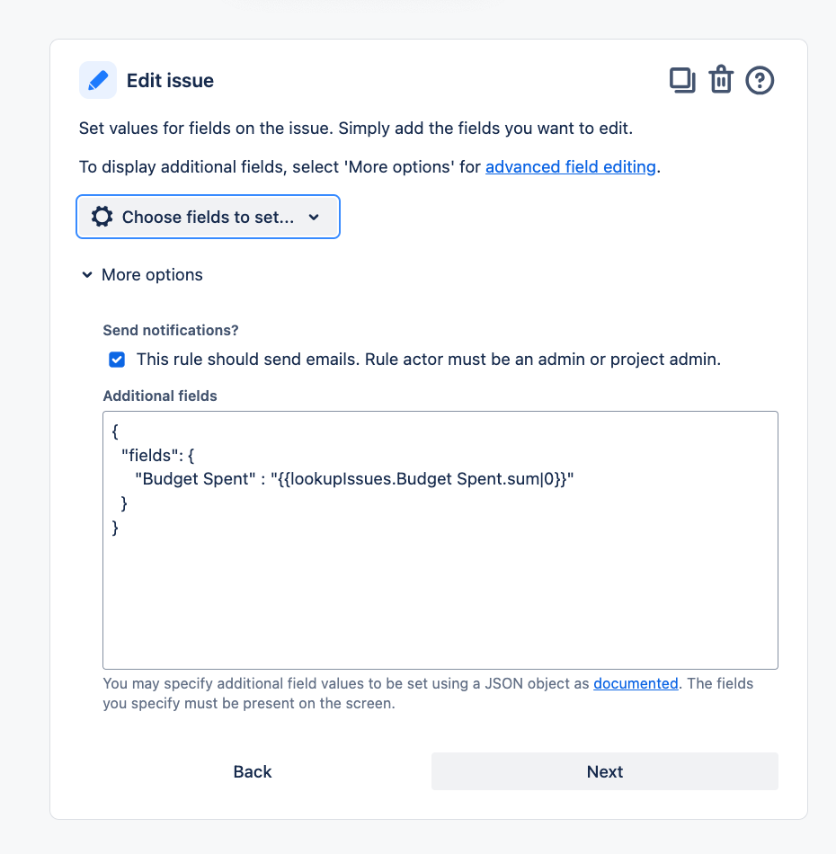

- JSON advanced edit is actually complete, nothing else happens
-  audit log - N/A, rule doesn't save with these specs, so we don't even get to the execution part

You noted you checked the field's ID to confirm it.  Did you also note the capitalization exactly matched what you are using for the smart value in the JSON?  If it does not match that will not work.
Regardless, let' try the custom field ID in place of the smart value for the "Budget Spent" field.  Please substitute in your specific field id value.
"fields" : {
"customfield_12345": "{{lookupIssues.customfield_12345.sum|0}}"
And if the custom field is a number-type, please remove the quotation marks in the JSON for the value:
"fields" : {
"customfield_12345": {{lookupIssues.customfield_12345.sum|0}}
As an aside, there is a change rolling out this week adding better validation to rules.  I wonder if that is causing this symptom:
https://confluence.atlassian.com/cloud/blog/2025/01/atlassian-cloud-changes-dec-30-to-jan-6-2025#:~:text=Validate%20more%20components%20in%20Jira%20and%20Confluence%20automation%20rules
