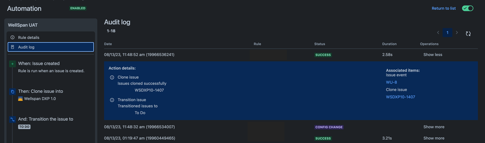

I have service desk support ticket set up and the clients fills out the form and then automation clones that ticket and then puts to another project. All that works but I can’t seem to change the status of the new clone ticket after the clone ticket trigger. It changes the status of the original tickets which I don’t want it to. What am I missing?

@Sayed Bares [ServiceRocket]  Here is the screenshot of the automation rule and audit logs Screenshot 2023-08-13 at 11.49.37 AM.png

After you clone the issue, you need to first Branch to Most Recently Created Issue.  Then you can transition that.
And also...Because this will try to edit the issue in the other project, this rule will need to be global scope, and then select both projects.
You appear to be on a Premium license level and so the limits on the number of global rule executions per month may not be a problem with that approach: https://support.atlassian.com/jira-cloud-administration/docs/explore-jira-cloud-plans/

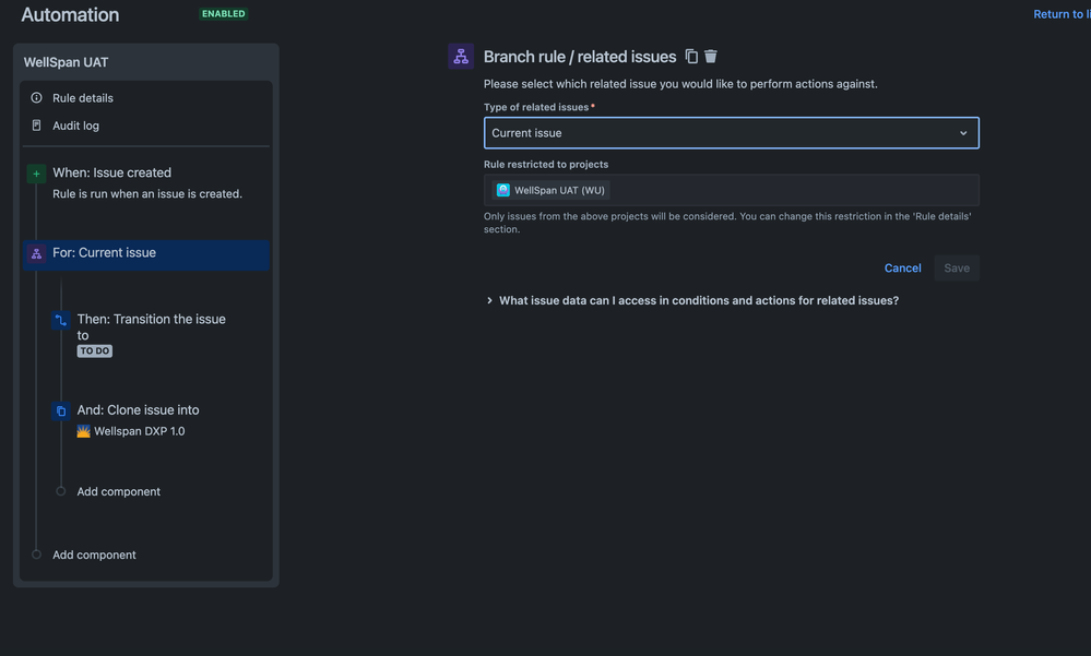

How can I modify the global scope to select both projects? I'm currently limited to selecting just one, even though I have Jira Administrator privileges.Screenshot 2023-08-13 at 3.08.58 PM.png

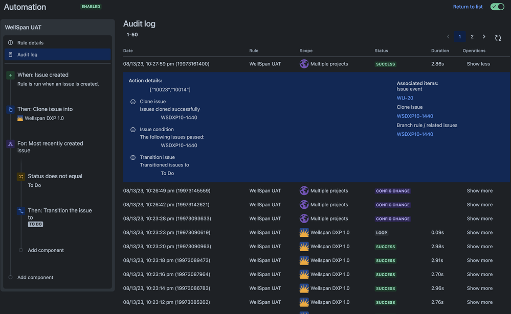

@Bill Sheboy @Sayed Bares [ServiceRocket] I believe I have successfully set it up as shown below. Could you confirm if this is the recommended approach? It is achieving the desired outcome, but I want to ensure there are no unnecessary steps involved.Screenshot on 2023-08-13 at 22-29-31.png

@Kevin Kashou That is the correct approach and should work.
