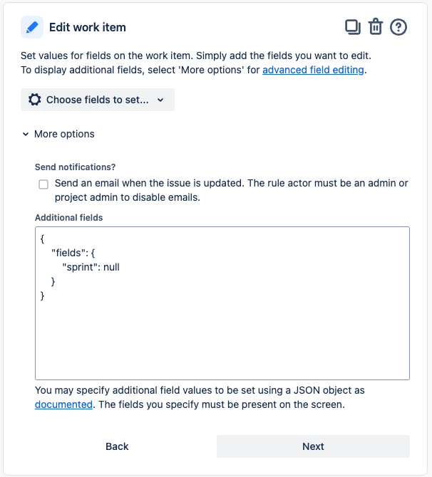

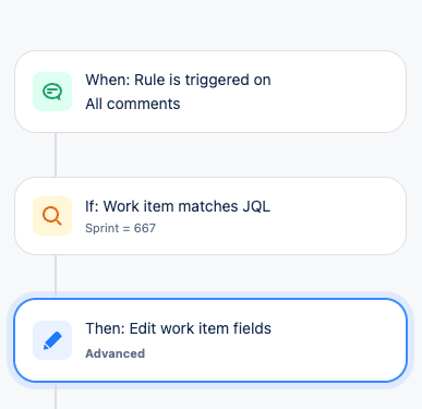

I have automation that moves issues that in a particular sprint to the backlog if they get commented on:
Up until May 13th this automation was working, but as of May 21st it started failing.
The action is configured with 'edit work item' using the advanced fields":
  "fields": {
    "sprint": null
Did something change to the allowable fields?

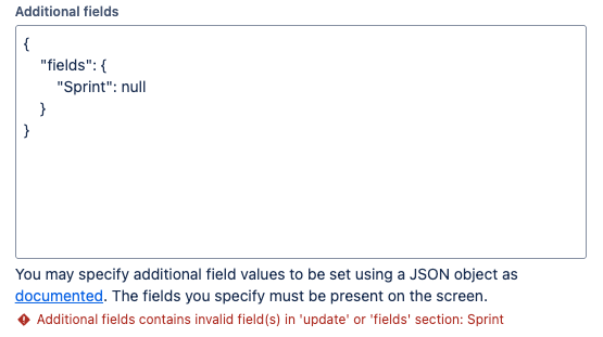

Have you tried changing the field name to "Sprint" in the JSON code?
It is possible that a new custom field named "sprint" (with a lower case "s") has been added to the system, making it not possible for the automation to determine which sprint field you are targeting. You could use the "customfield_12345" nomenclature to explicitly identify the field you want to edit.

Thanks for the suggestion Trudy!
That still seems to fail:
How would the customfield_123 nomenclature work? I thought Sprint was a standard field.

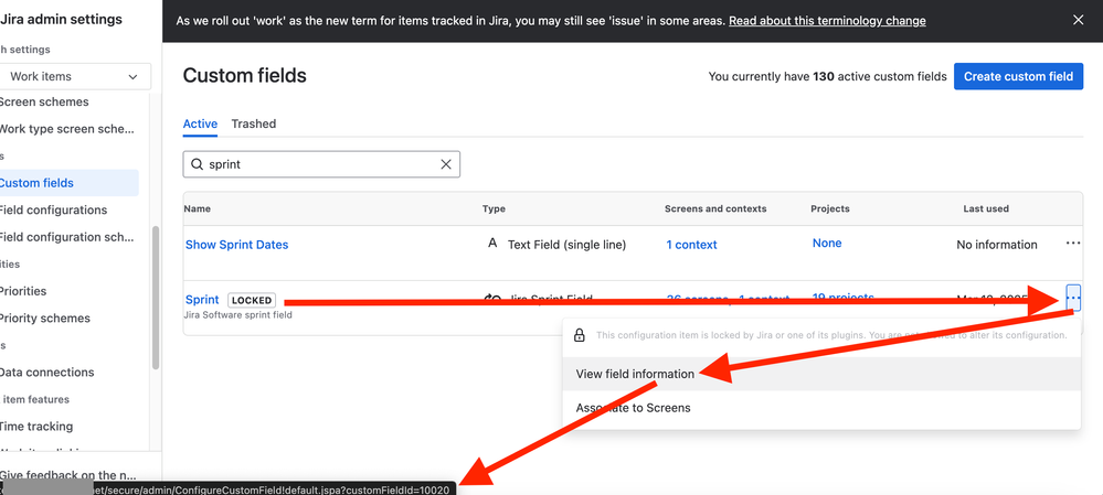

If this rule is scoped to Company Managed Software project(s) and you are a Jira Product Admin, then you could also go to the Jira Admin Settings > Work Items > Custom Fields, find the Sprint field that is "locked" and get the ID from the URL that displays when you hover over the configuration options for the field.

Thanks again Trudy! Using the customfield from that url fixed the issue. Appreciate it.
I'm not an admin. I'm still not sure why this changed but I'm happy its working again.
