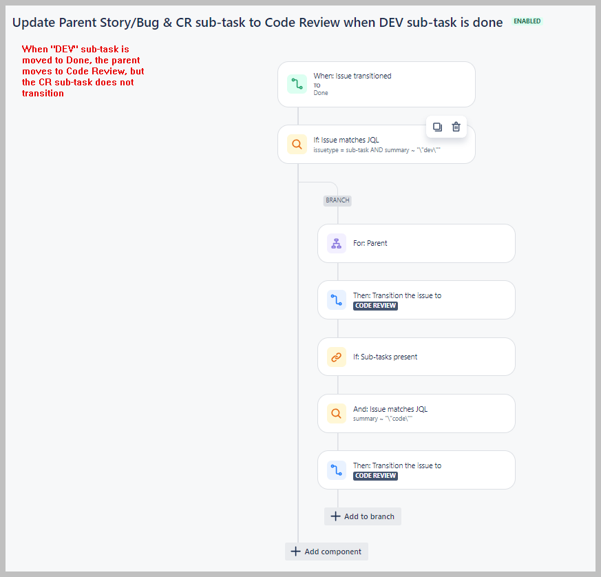

I've created the following rule:
When the DEV sub-task is transitioned to "Done" > Update the Parent to "Code Review." Then update the "Code Review" sub-task to Code Review as well.
The first step is working, the parent is moving to Code Review after the "Dev" sub-task is moved to done. The Code Review sub-task however is not updating.
Any guidance or tips would be greatly appreciated!

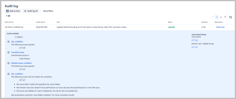

Here is what the audit log shows: 2024-10-18_10-51-07.png
Stacey Jones
October 18, 2024
CCT-87 is the parent
The code review sub-task that is not updating is CCT-90, which isn't mentioned in the log.
john.monteith
October 18, 2024

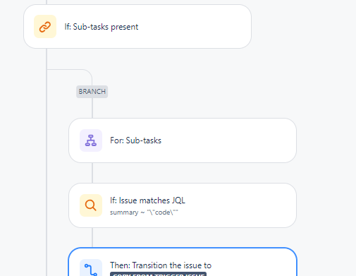

The subtask is not being referenced because your branch is for the parent issue (CCT-87) so when you run your JQL conditional statement it is checking if the "Issue matches JQL" that issue at this point being the parent issue.
What you can do is that if your if condition regarding subtasks of the parent issue being present is true, then create a branch for those subtasks and check to see if they meet your JQL condition, if they do, then transition them to "Code Review"

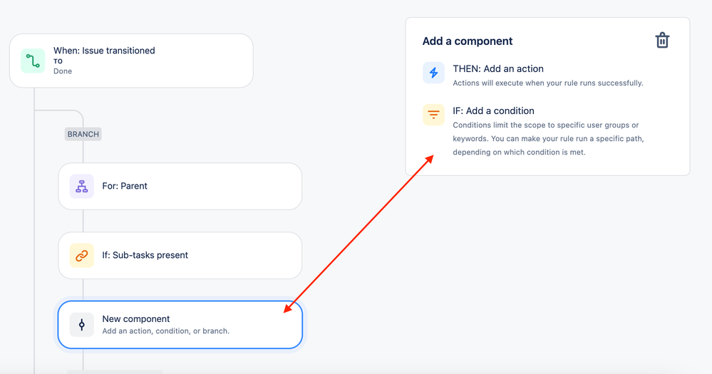

Trudy P Claspill
October 18, 2024
@john.monteith It is not possible to create a Branch inside of another Branch. Notice that FOR is not available at this point.

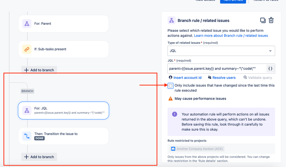

@Stacey Jones
You will need to add a separate branch to your rule to change the focus to the "sibling" sub-task:
Use the For: Related Issues: JQL option and a JQL to find the desired sibling subtask. Make sure that you uncheck the box indicated by the arrow in the image above.
