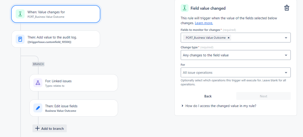

Working on setting up Automation rule between two projects (one is JDP and the other is JSP).
I have successfully setup a automation rule from a value change in JDP to then edit linked issues (e.g., relates to) corresponding field.
However, when I try to setup a automation rule going the other way (value change in JSP to then edit linked issues (e.g., relate to) in JDP the rule fails,

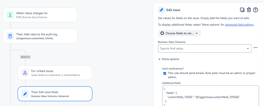

I have create the automation rule as follows (from value change in JSP to edit related field in it's linked issues (e.g., in JDP):
I have also typed in the box below Business Value Outcome: {{triggerIssue.customfield_10504}}

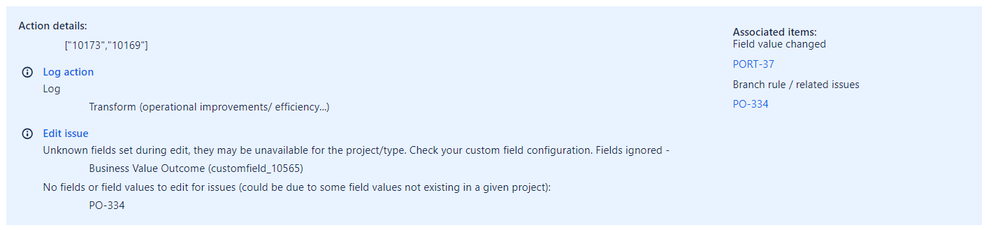

I have research round and round but can't get the field working... my audit lot is:
When I go to Jira Setting -> Custom Fields... I'm unable to see "any of the JDP" fields in this view.
TIA for any support.

First thing, I note Edit Issue action appears to have the "Business Value Outcome" field selected from the dropdown list and updated using JSON (using its custom field id).  Only one of those methods may be used for a specific field at a time in a single edit.  Please try removing the JSON and pasting the smart value expression into the field edit:
Next, what type of field is customfield_10504: text, single-select option, multiple-select option, etc.?  The type of field may impact how to perform the edit of the JPD field.
Same thing for the JPD custom field, "Business Value Outcome".
Finally, issue linking is often directional, especially for JPD <-> JSP (Jira Software Project).  But your branch is checking link types which are in both JPD and JSP issues.
If you want the branch to select the JPD idea for the JSP trigger issue, please change the branch to only check "implements".

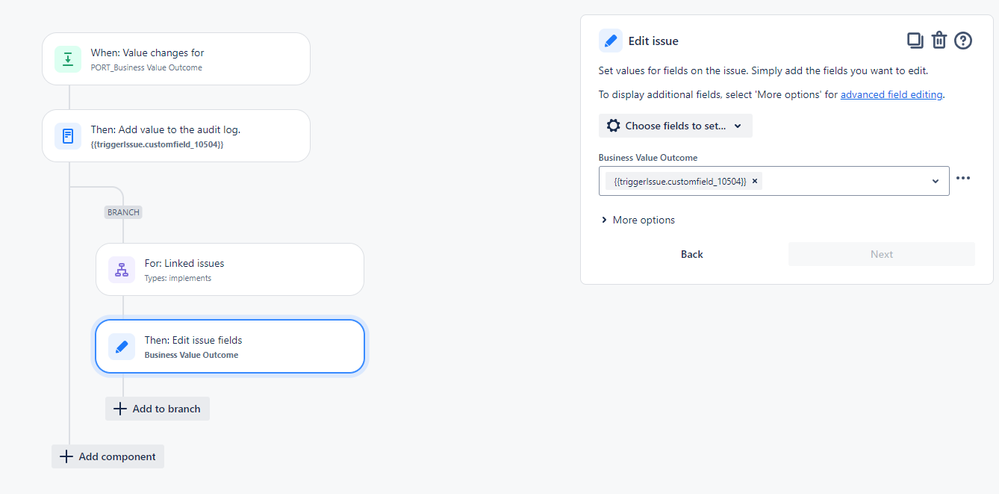

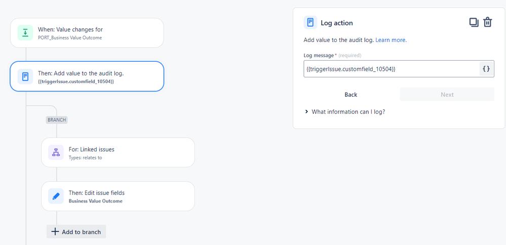

Selena Peri
June 28, 2024
Kia ora Bill,
Thanks for your reply!
You are correct I had been testing using JSON code (as I was trying all various ways...)... when trying on way I didn't have JSON code in there and it was only {{triggerIssue.customefield_10504).
Customfield_10504, a JSP field, is setup as field type: radio button. The linked issue field, in JDP (the field to be edited), is field type: multi-select (customfield_10565).

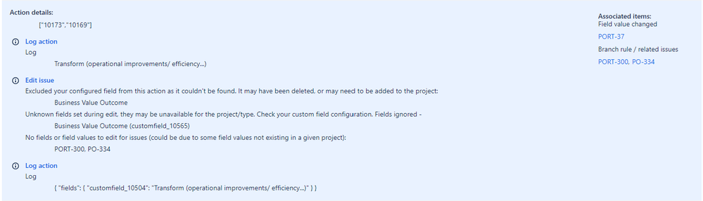

Still no luck as  per screenshots (updated rule and audit log outcome after retrying):Screenshot 2024-06-29 102830.png

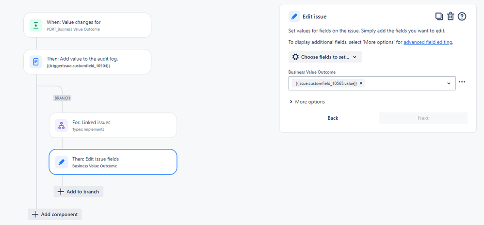

Selena Peri
June 28, 2024
Kia Ora,
Again - thank you for further support.
OK so in the EDIT section I update the Smart Value to: {{issue.customfield_10504}} or {{issue.customfield_10504.value}}... customfield_10504 is the JSP field that I'm changing... and want that change made to customfield_10565.
I'll try above however, sorry, this part - besides bullet point #2 am I making possible another changes to my rule?
  • select the JPD field in the dropdown list
  • enter the smart value expression {{issue.customfield_10138}}
  • when the value appears below the field, select it for use in the edit

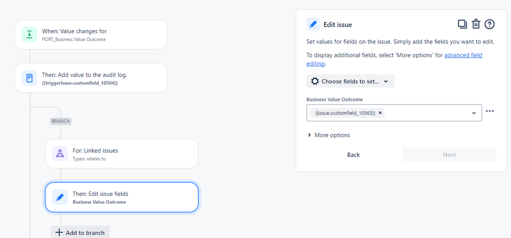

Selena Peri
June 28, 2024
Update:
Still no luck at my end...
EDIT section updated as follows:

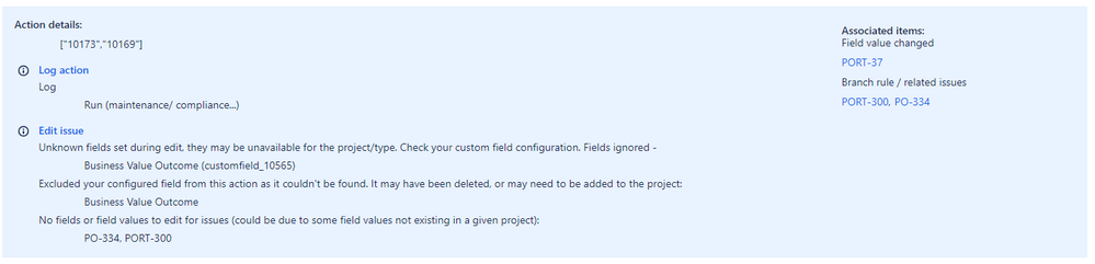

and audit log is same as others:
in my FIELD VALUE CHANGE: is this configured to say when my JSP customfield_10504 is changed...

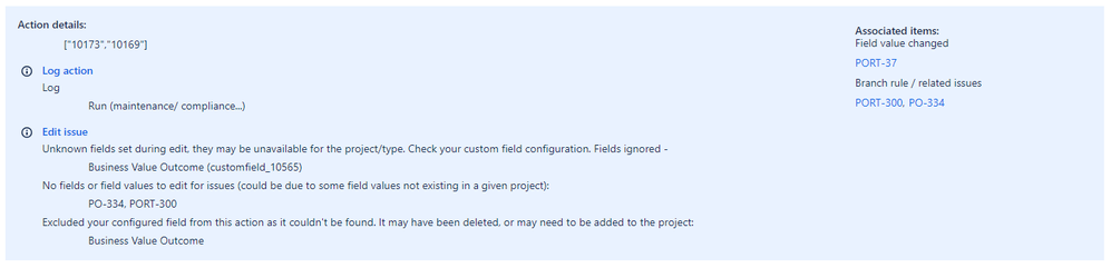

Bill Sheboy
June 29, 2024
It appears someone linked together two JPD ideas with the "implements" link type: PORT-37 and PORT-300.
Thus PORT-300 is also found by the branch, and JPD ideas do not have the JSP field, Business Value Outcome, leading to the rule error.

Selena Peri
June 29, 2024
Kia Ora,
hmm -> ok, still not luck... I removed linked issue PORT-300 and I get the following error log:
I tried on another JSP issue... changed PORT_Business Value Outcome (10504)... and the linked issue (relates to) to change JDP field: Business Value Outcome (10565) -> same error log:

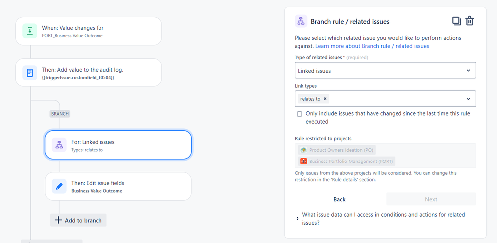

This is how my rule is configured:
WHEN
THEN
BRANCH
Honestly - thanks for looking in to this - just very confused why it's not working... it seems in the Audit log that on the impacted issue (one where the value is to be edited) is doesn't recognise customfied_10565

Which project is JPD and which is JSP?  Knowing that will confirm if the triggers and link directions are correct.
Why did you change the branch on linking from "implements" to "relates to"?
Selena Peri
June 29, 2024
Kia ora Bill,
JDP is the issue that is to be edited (Business Value Outcome: customfield_10565) - company managed project.
JSP is the trigger issue (PORT_Business Value Outcome: customfield_10504
I removed "implements" and changed to "relates to" -> because the issue to be 'edited' was a linked issue by "relates to" connection.
I didn't realise I had that branch config wrong... when I had PORT-300 linked that was by "implements".

Bill Sheboy
July 1, 2024
Short version: it appears your scenario has uncovered an apparent defect in automation rules with JPD idea / issue edits and multiple-project scope rules.  There are known limitations with JPD and automation rules, but this one is not listed.
I recommend working with your Jira Site Admin to submit a defect here to learn what they suggest: https://support.atlassian.com/contact/#/  I recommend including a link to this community question so the support team can observe what was tried.  When you hear back from them on a solution, please post what you learn to benefit the community.  Thanks!
I do see an error in the last images you posted, where the edit issue action uses the incorrect custom field id, but that does not impact the apparent defect.
