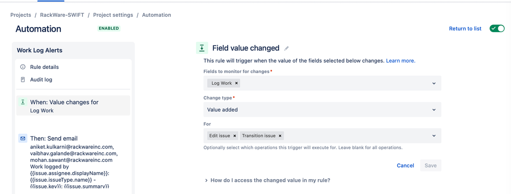

Hello,
Recently, I added a simple automation rule for JIRA to send us Teams channel notification anytime there is work log entry across bugs/stories/enhancements. JIRA automation has field change alerts for work log. However, it is not working. It doesn't send any error email either so looks like this field change not working is a bug in cloud JIRA? Anybody tried this?
I am sharing a snapshot of rule below. I already have automation for alert on original-estimate change and that is working fine, but it can't process work log change events under that rule.
PS - Automation for other areas is working absolutely fine. We use a bunch of automation rules. Even alerts on time estimate change working great otherwise, just that it can only act upon original-estimate and not work log.

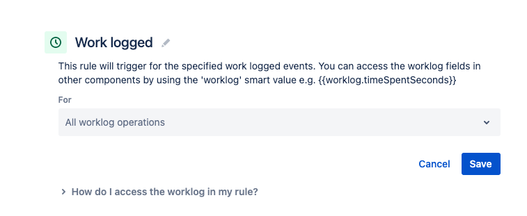

If you want to be notified when work is logged, then you need to use the Work Logged trigger, not the Field Value Changed trigger.
Aniket Kulkarni
February 21, 2023
Thanks, Trudy. The suggestion worked!
