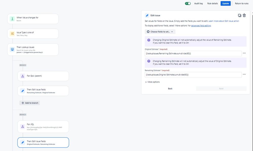

Hi @Bill Sheboy , thank you for this. It is updating the previous epic estimate fields now but not correctly and wonder if it's my final "then" that is causing the issue? I've pasted the below, so the new parent is updating correctly but it appears the old epic is just getting 1 hour added to the estimate fields..

To update the old epic, the lookup needs to be repeated for the old parent.
To make things easier to understand in the rule, try nesting the lookups consistently, like this:
  • trigger: value changes for parent
  • condition: issue type is one of Task, Story, Bug
  • branch: to parent (This will be the current parent)
    • action: lookup issues to gather the siblings with the same parent
      • parent = {{issue.key}}
    • action: edit the issue (i.e., branched-to current epic) to update the fields
  • branch: to the old epic with JQL
rob.jeal
February 14, 2024
Perfect, thanks @Bill Sheboy that's worked a treat! Appreciate all your help and explanation too, really helpful
