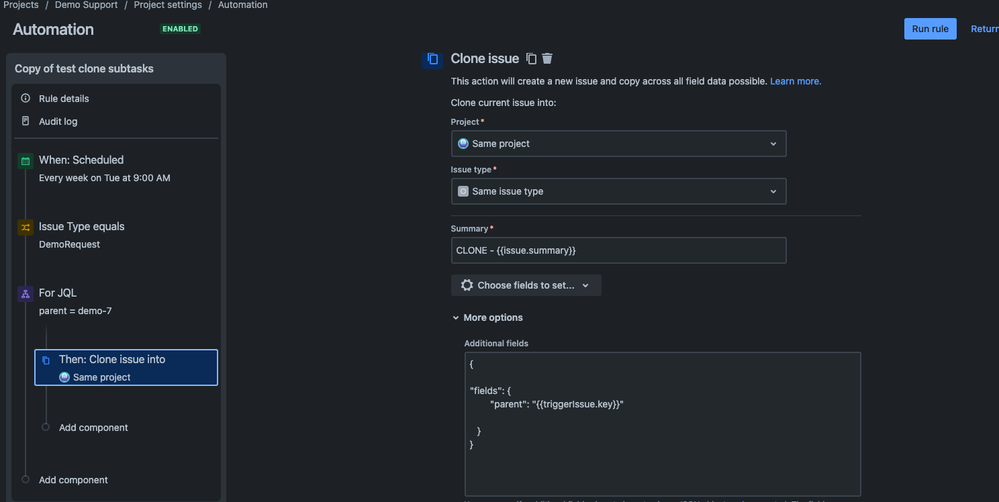

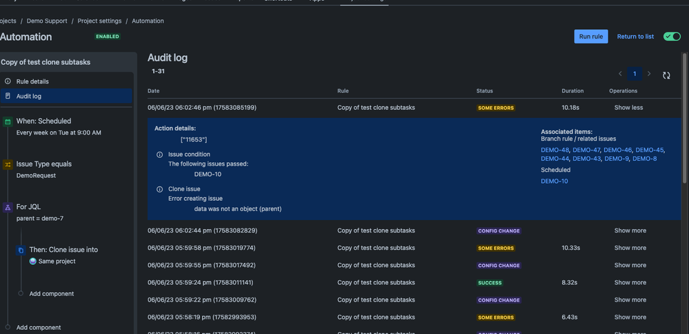

I should be able to update the parent of a sub-task in automation for jira. I don't see the parent option in the fields drop down, but when I try to configure it via advanced editing I am unable to do so. The rule does not error out but it does not update the parent either
The below does not error out, but it does not update the parent

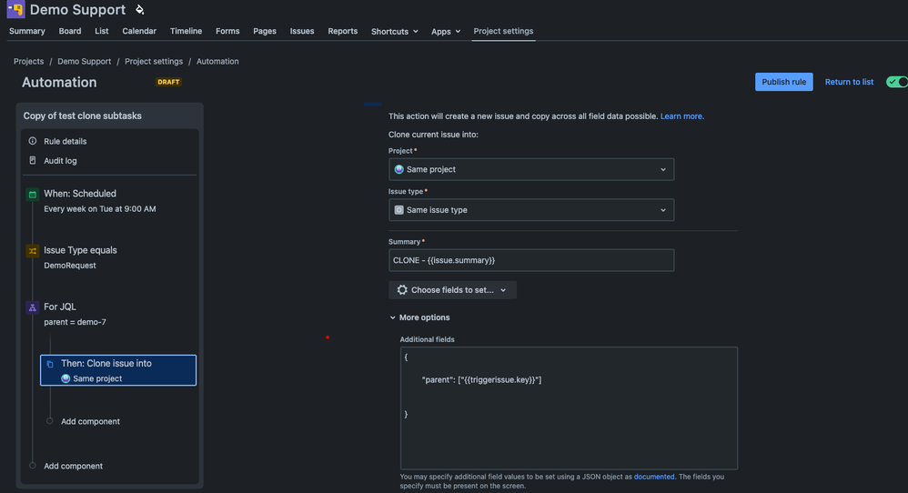

The below errors out
"fields": {
"parent": ["{{triggerissue.key}}"]
(I've also tried "parent.key" and automation won't even let me save the rule)

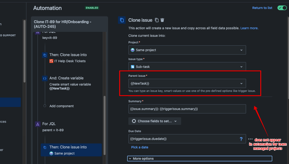

I am able to successfully do this in company managed projects

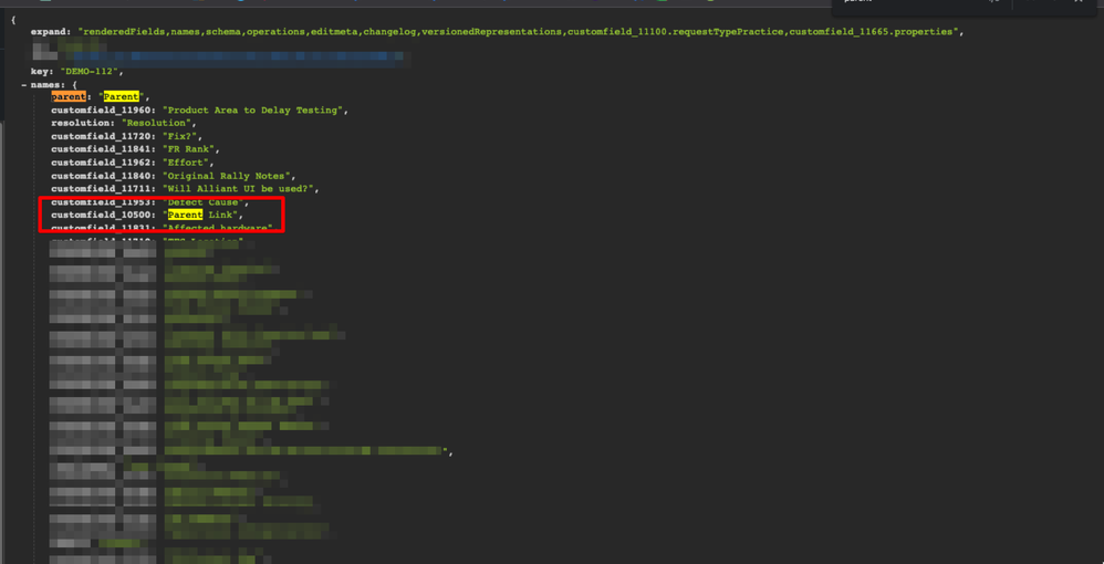

I got it to work using the following JSON
"fields": {
"customfield_10500": "{{triggerIssue}}"
I found the parent link custom field value in the JSON for the issue
Monosnap rightsline.atlassian.net_rest_api_2_issue_DEMO-112_expand=names 2023-06-06 18-19-45.png

Finally, I notice that you appear to be creating a variable {{NewTask}} in one branch and then using it in another.  That will not work because the variable will go out of scope, and so become null.  Without seeing your complete rule I cannot offer alternative rule structures.

Thank you, the screen shot with {{NewTask}} is actually a sample from a different automation rule where everything works OK, and I can create a variable in one branch and use it in another (tested and it works).

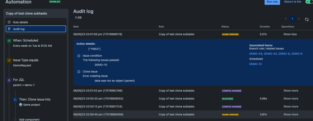

However. I have updated the problematic automation rule per your suggestion and no dice. Here are screen shots from my entire automation rule as well as the error.
"fields": {
"parent": "{{triggerIssue.key}}"
Monosnap Demo Support - Details - JIRA 2023-06-06 18-01-57.pngMonosnap Demo Support - Details - JIRA 2023-06-06 18-02-14.png

Thanks, @Jeffrey Bistrong and I recommend confirming your created variable and branching works as you expect in that other rule...
Branches on more than one issue/thing processes separately, and asynchronously, from the rest of the rule.  There is no guarantee of when such a branch will complete...up to the last step of the rule.
What this means is that if you are setting a variable inside of a branch, two things happen:
  • the variable is re-created over and over as new, each time a branch item processes, and then goes out of scope afterwards and disappears (the exception is branches which can only process one thing, such as on epic parent)
  • there is no guarantee the variable will be available to any steps after the branch at a predictable timeframe
