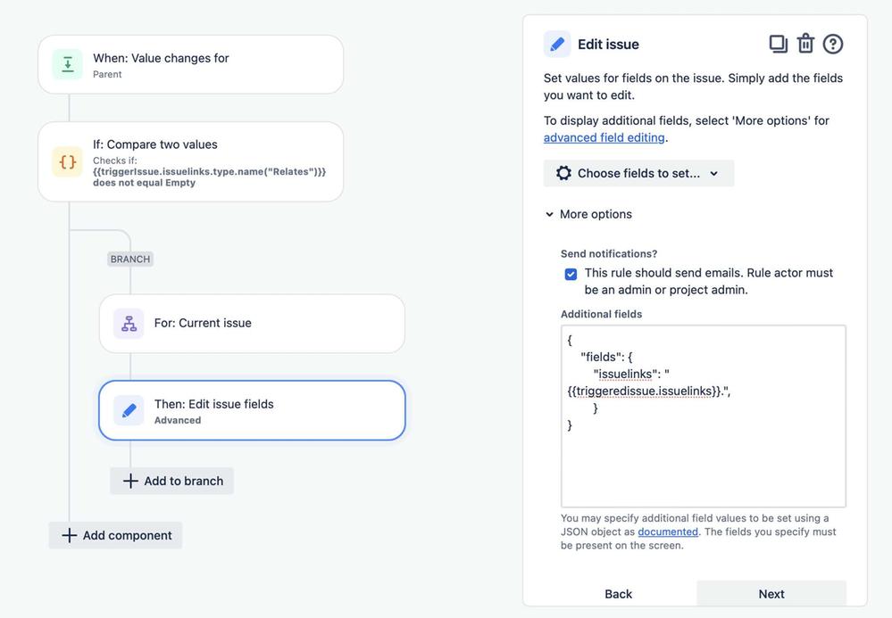

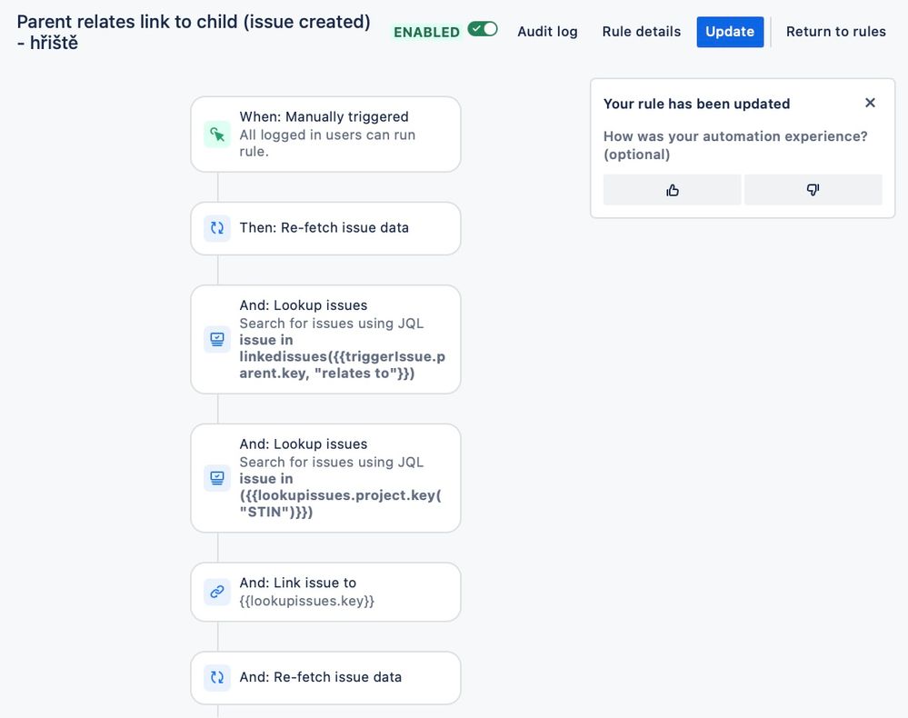

Hello community!
We can not achieve an inheritance of linked issues with "relates to" relation only from parent to child once a child is created.
We tried using smart values but could not find a way how to express it to the automation to get it to work.
You can see a draft of a rather general approach to inheriting any of the linked issues in the attached screenshot.
Could you please help us how to achieve it?
Thank you!
Bill Sheboy
February 23, 2024
Hi @David Exner
You cannot directly set the issuelinks field only, as shown in your rule image.  The reason is both issues which are linked are updated during the linking operation.  And, I believe the REST API only supports linking two issues, and not one issue to many others.  (Although I have not tested that.)
Instead consider finding the issue keys for the issues to link-to, and then using an Advanced Branch iterate over the keys and use the Link Issues action.

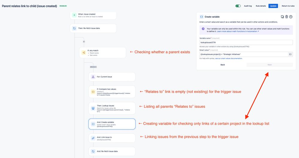

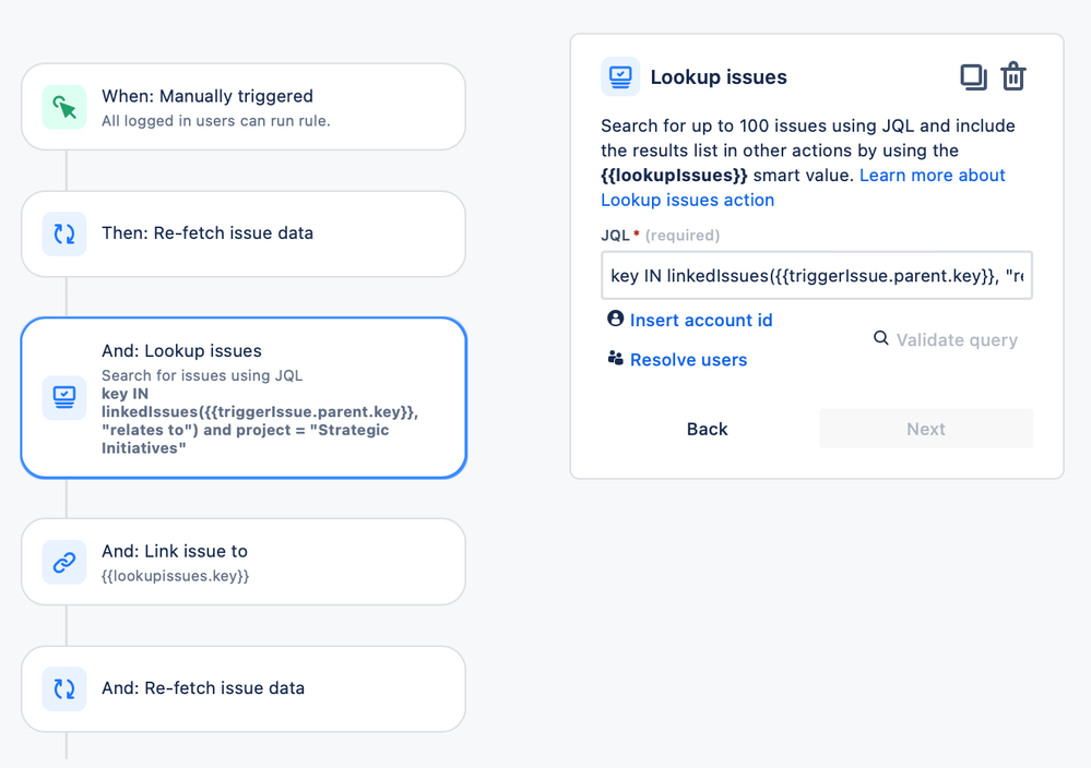

Uff, so I am not sure whether I can achieve what we need to since it resulted in the successful run of the rule but the new issue was not assigned with any "Relates to" links while the parent has them. Any ideas, please?
Bill Sheboy
March 12, 2024
I am confused as what that rule is trying to do.  For example, that created variable will produce a text string that looks like below, and then try to link that to another issue:
SEP, SEP, SEP = "Strategic Initiatives"
Would you please explain / confirm what problem this rule is trying to solve?  It seems what you initially described is:
  • GIVEN an epic exists which has linked issues of type "relates to"
  • WHEN an issue is created which is a child of that epic
  • THEN link the same linked "relates to" issues to the new child issue

David Exner
March 12, 2024
Ok, here it is:
  1. Trigger: issue created
  2. Check whether this newly created issue has any parent or epic.
  3. If so, check whether there are not any "Relates to" issues linked to the newly created issue.
  4. To look up all issues, that are linked to the parent of the newly created issue.
  5. That should be a variable with all the issues from lookup belonging to the project "Strategic Initiatives" <- After your comment, I realized that I mixed up two things together, I guess I should rather look up these issues again.
  6. Once the belonging issues are found link them to the newly created issue.
Thank you for your help @Bill Sheboy !

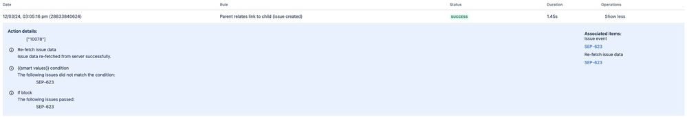

David Exner
March 14, 2024
The rule is, for now, set up only for newly created issues of only one project (SEP)- we want to test-run it there. We just need to link these new issues to the related Jira issue from the different project = STIN ("Strategic initiatives"), which is currently linked only to their epic/parent.
We were also thinking about creating a new "STIN" field storing the key of the STIN Jira issue, but we wanted to avoid the need to add one more custom field if we can already use the existing linking feature.
Anyway, if we find out that the linking is not a good idea, we will want to be able to read the linked STIN Jira issue of the parent and then save its key to the "STIN" field of the children.
I hope it is clear :)))

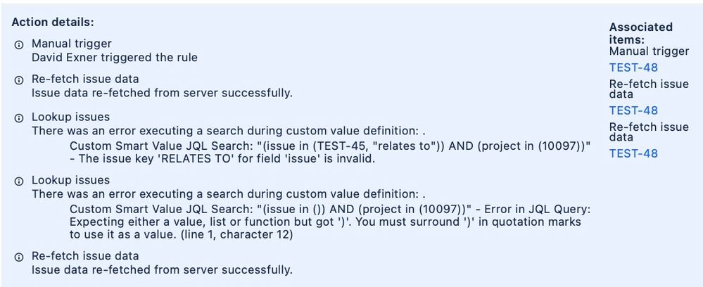

David Exner
March 14, 2024

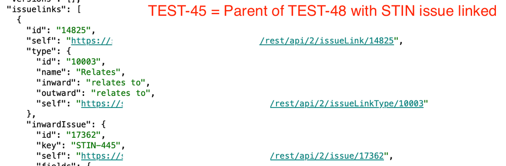

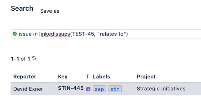

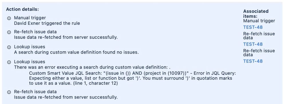

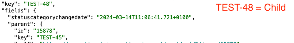

Hmm, so I probably found an issue with:
issue in linkedissues({{triggerIssue.parent.key}}, "relates to")
If I use: issue in ({{triggerIssue.parent.key}}, "relates to")
The parent is recognized by the automation even though it results in error because of "relates to" which makes sense:
But if I use: issue in linkedissues({{triggerIssue.parent.key}}, "relates to")
The parent is not even recognized (1st "Lookup issues"):
But if I use the search it in issues with the parent "TEST-45" mentioned directly in the query, it works and I can find the related Jira issue (STIN-445):
issue in linkedissues(TEST-45, "relates to")
It seems like smart values can not be used for linkedissues().
I also simplified the rule:
Bill Sheboy
March 14, 2024

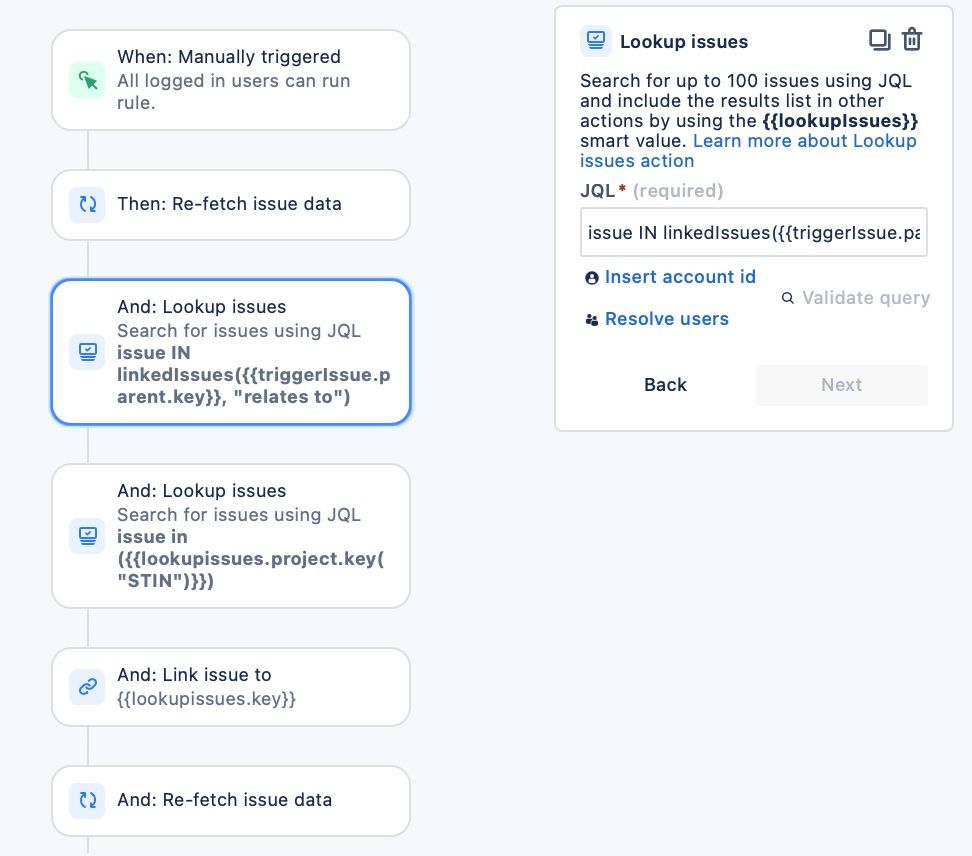

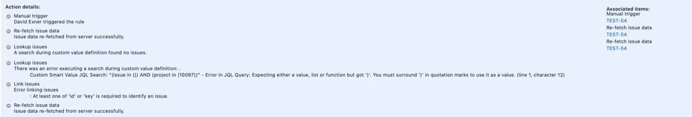

Your lookup issues action has the curly brackets in the wrong place in the JQL.  Please try this:
issue IN linkedIssues({{triggerIssue.parent.key}}, "relates to")
Like • David Exner likes this
David Exner
March 15, 2024
My bad, it was done by mistake while playing with it, thanks. Anyway, after correcting it, the result is still the same:
Should I refer differently to the issue and not by using a key?

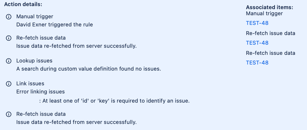

Bill Sheboy
March 16, 2024
Just to confirm, you want those linked issues which are only in the STIN project, correct?
If so, please change the JQL for the first lookup issues action to this:
project = STIN AND issue IN linkedIssues({{triggerIssue.parent.key}}, "relates to")
And then the second lookup is not needed.
David Exner
March 18, 2024
Good point, thanks!
Anyway, It is still not working.
The linked STIN-445 issue ("relates to") to the parent of the newly created issue is still not captured.
But in issues, the JQL is working fine:
I am not gonna lie, I am now a bit desperate :)))
Is not the referencing {{triggerIssue.parent.key}} wrong?
Thank you for your continuous support! It is much appreciated.
Bill Sheboy
March 18, 2024

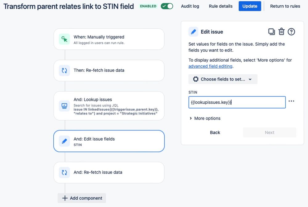

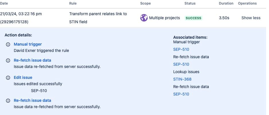

Btw, since we realized that this approach is not the best (we can end up having hundreds of issues linked to the STIN issue), we would like to use the current automation for listing the STINs linked to the parent and then filling their key(s) to the new custom text field (single line) "STIN".
We tried to change the automation to this one below, instead of using "Link issue" we added  "Edit issue" +  we used a smart value "{{lookupissues.key}}" as a new field value:
Despite having the status "Success" the value was not written to the "STIN" field. Do we miss any data type transformation? Or what else could go wrong, please?

Bill Sheboy
March 21, 2024
That format() function should not be needed as the following produces a comma-separated list of keys:
{{lookupIssues.key}}
You can force that to text with this:
{{lookupIssues.key.join(", ")}}
Also, try writing the number of items to the log after the lookup to confirm what was found:
lookup found issue count: {{lookupIssues.size|0}}
