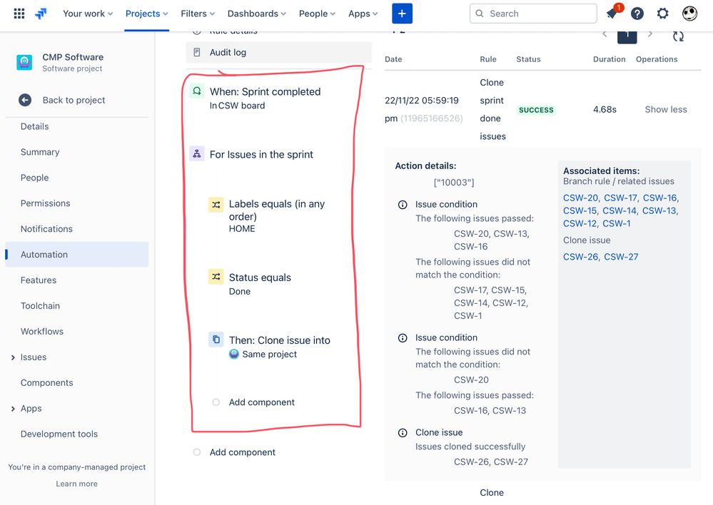

Thanks for the reply. Let me clarify the case a bit.
Cloning should be done on the basis of closing an issue with a certain label.
For example issue 'X' is closed in the current sprint with Label 'Security', then this issue is cloned when the new sprint is started etc.
Jack Brickey
November 22, 2022
Give this a go...
Like • Michael Mooijman likes this
Michael Mooijman November 25, 2022
Thanks for the reply. I have tested the automation and it works. Thanks for this. Now I have another question: is it possible to create an issue recurring for a Kanban board?

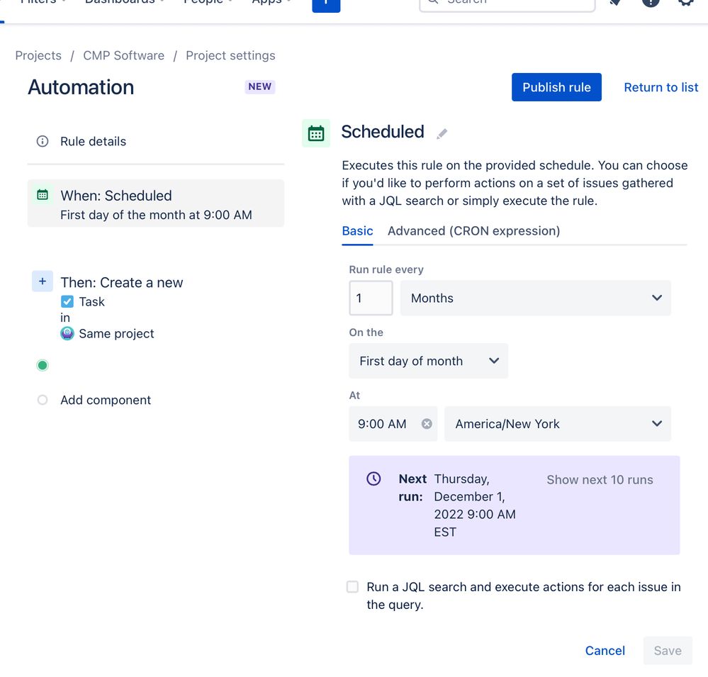

I would like a (clone) issue to be created every 3 months from an existing issue via automation. The existing one does not have to be closed yet. So it is a recurring task.
Jack Brickey
November 25, 2022
So if you are going to create an issue every 3 months then you really don't ant a Clone action I think but rather simply use Create and fill in the desired fields.
