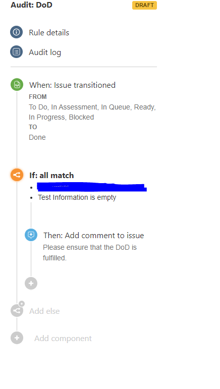

I try to create one automation:
I have various statuses. You can transition from any status to any other.
If the transition is made from "StatusA" or "StatusB" to "Done," a comment should be written.
Thanks, BR

Andreas Deogarevic
November 30, 2023
Hello
I also have a status "in testing" and I want this automation to appear  only if the status "in testing" has been skiped.
Right now, if I go from "in testing" to e.q. "to do" and then to "done", the automation would run.
BR
Bill Sheboy
November 30, 2023
That check may be added using a JQL condition and the operator WAS NOT IN: https://support.atlassian.com/jira-software-cloud/docs/jql-operators/#WAS-NOT-IN
For example, the JQL condition would be after your trigger, and use this:
status WAS NOT IN ("In Testing")
This would ensure only issues that had never been in that status would proceed.
Andreas Deogarevic
December 1, 2023
Thanks a lot Bill. Works as expected. BR Andreas
