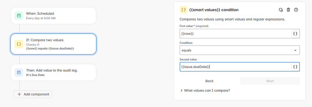

Hi, @komal.mathur.-nd
If I understand your request correctly, you want to perform an action (such as logging work) when an issue reaches its due date.
You can achieve this by creating an automation rule with the "Scheduled" trigger, set to run every day.
Then, add an IF condition to check whether now() equals the issue's due date {{issue.duedate}}.
If the condition is true, proceed with the required action — such as logging work or sending a notification.
