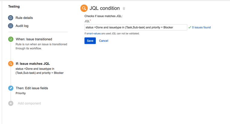

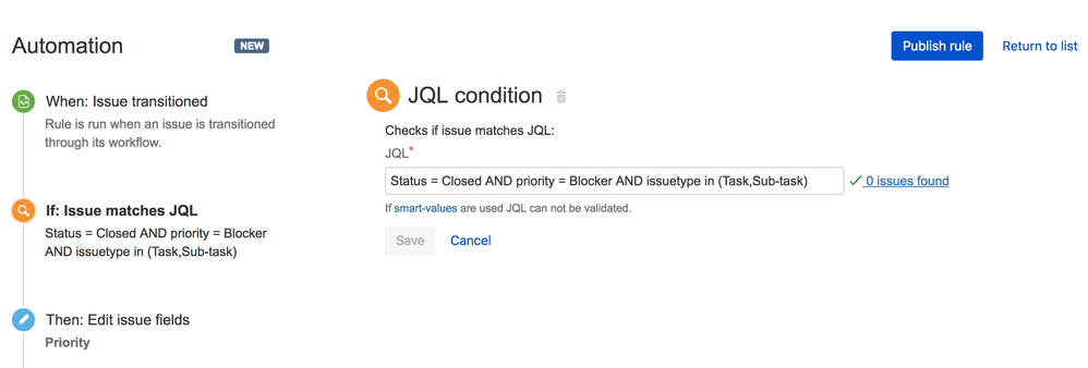

Hi,
I am assuming you mean the Automation for Jira add-on, not the one built into service desk? With the add on you can apply this to any project, not just Service Desk ones. The rule (pictured below) using the add on would essentially be:
  • Trigger: Issue Transition
  • Condition: JQL
    - Status = Closed AND priority = Blocker AND issuetype in (Task,Sub-task)
  • Action: Edit Issue
    - Select "priority" from the "choose fields to select"
Let me know if that works for you.
Cheers,
Scott

May 29, 2018
Hi
I tried your way, Its funny, When I hit close, it won't change the priority, but when I reopen the issue priority is updated.. any thoughts?

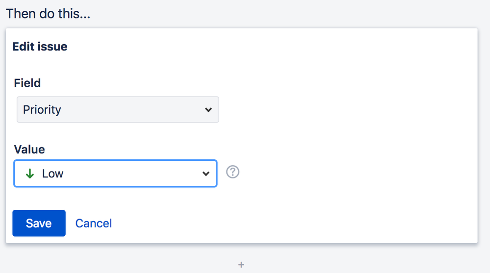

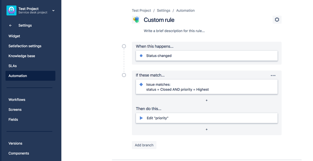

May 25, 2018
Hi @KRC,
Try to create a custom rule in the project automation something similar the configuration you see in the screenshot attached.
1. When this happens...  - use Status changed.
2. Add a condition and use an advanced filter. - Status = Closed AND priority = Blocker AND issuetype in (Task,Sub-task)
3. Then do this...   - Choose field Priority and set value to Trivial.
Save the configuration and try to close the issue and you should be able to achieve the required functionality.
Hope this helps!!

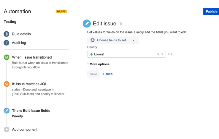

Deleted user
June 6, 2018
Hi @KRC,
The same configuration works well with "Automation for JIRA" as well.
Try to use the JQL condition as status=Close and issuetype in (Task,Sub-task) and priority=Blocker
In "Then" configuration choose field Priority and set value to Trivial.
action.pngOnce the transition is executed try to reload the page and you should be able to see the priority field value as Trivial.
