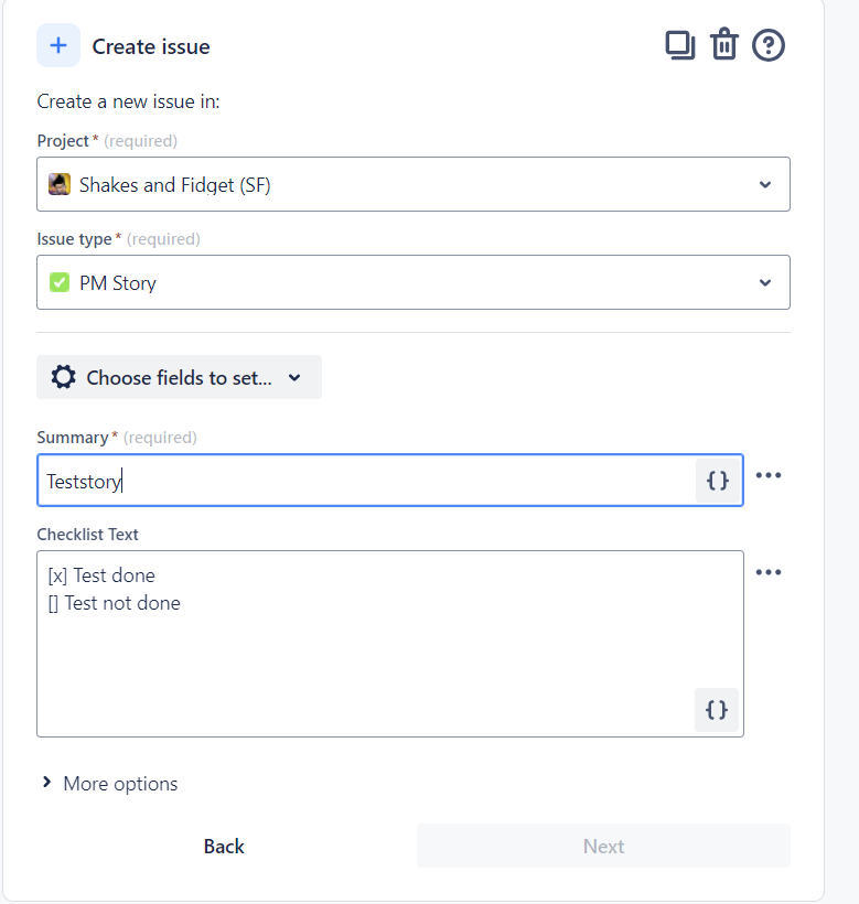

I tried to setup an automation that creates an issue with a Checklist.
I have an automation that is scheduled and it has the create Issue action.
Projekt is given, Issue Type is set and it has the summary field filled.
Then I added the field
Checklist Text
[x] Test done
[] Test not done
I would now expect when the Automation is running that the Issue is created and will have the Checklist in the Issue that is created.
Instead my created issue has a field "Checklist Text"
with the text in it:
[x] Test done
[] Test not done
Am I missing a step somewhere?

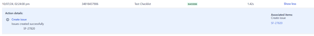

Can you show me the audit log of this automation? If you are using create issue in that automation, it is necessary to add Checklist Text custom field to the create issue screen.

This is the audit log of the Automation:
I am using Create issue in this automation. Also I made sure the field "Checklist Text" is available on all three screens (Create, Edit, View).

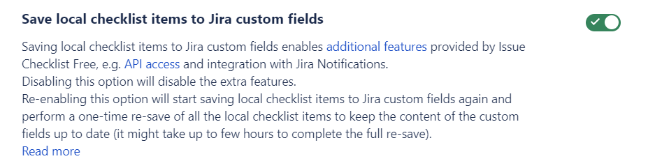

The automation was set up correctly and worked as intended, but the settings where wrong.
So in the Jira settings under "Apps" we went to "Global Settings" and scrolled down to "Save local checklist items to Jira custom fields" and turned it on.
After turning it on it worked.
Afterwards I made sure the field "Checklist Text" is only in the Create Screen and took it out of the Edit and View Screen. So it would be there on creation and hidden in the Issue view. Also in the Edit it is possible to go over the Checklist itself to edit it, so the "Checklist Text" field isn't necessary to edit the checklist.
I hope this helps everybody who gets stuck at the same problem.
