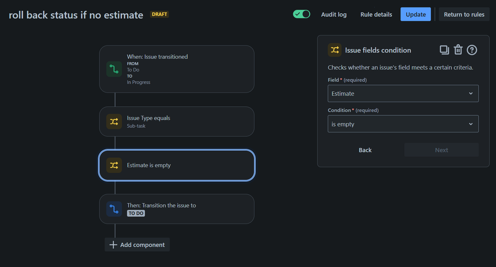

You probably want something like the screenshot below, where it triggers on transition and validates through issue fields conditions that it is a sub-task and blank estimate before changing the status back. You can also add a comment to the issue and tag the reporter, assignee, or person who initiated the transition with a note about the estimates being blank.
Adding a pop-up notification can be a little tricky. Usually that is done when you have a workflow validator (or a marketplace app / Forge custom app). This could work, but would apply to all issue types that share the same workflow (likely your sub-task shares same as higher issue types). If you did piece off your sub-tasks into a different workflow (maybe a simpler one) then you could absolutely add a workflow validator for the value of the estimates field and then it would only be for the sub-tasks. Those do allow you to put some custom message and they show up as a temporary pop-up in the lower left corner of the screen.

@Harrison Ponce thanks, I've missed the issue fields conditions, it helps a lot)
"You can also add a comment to the issue and tag the reporter, assignee, or person who initiated the transition with a note about the estimates being blank."  it was also helpful.
