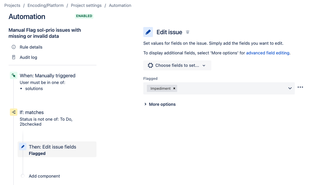

I tried a manual rule as a starting point:
but I keep getting the following error when I run it:
No fields or field values to edit for issues (could be due to some field values not existing in a given project):
   EN-11149
Found multiple fields with the same name and type: .
   Flagged (com.atlassian.jira.plugin.system.customfieldtypes:multicheckboxes)
I've checked our fields however, and there is only one `Flagged` field (which is locked)
And yet, if I manually flag the issue in the edit view, it does work. So the field exist and is usable...

Hi @Fabre Lambeau welcome to the Atlassian Community!
I just created an automation rule on my own site and it works.
  • When: Manually triggered
  • Status equals To Do
  • Then: Edit Issue fields Flagged (value Impediment)
Can you (or a Jira admin) check if you have a custom field with the same name 'Flagged' (type Checkboxes)?

Turns out there were 3. I have no idea why...
