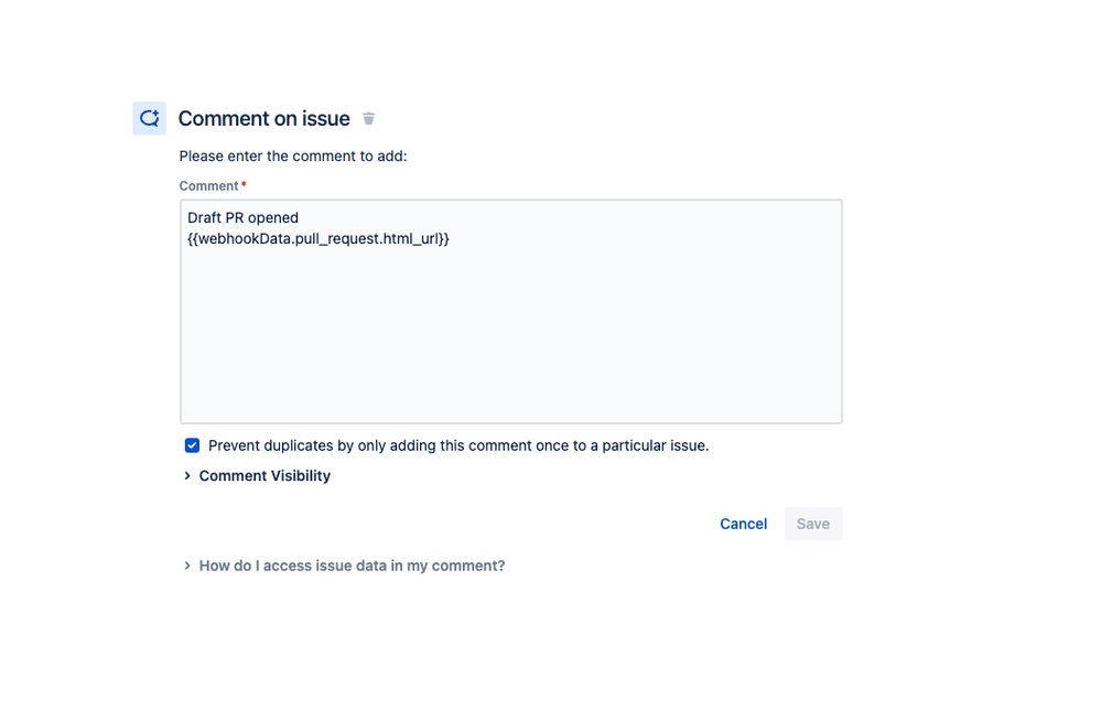

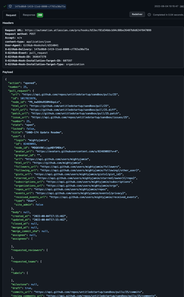

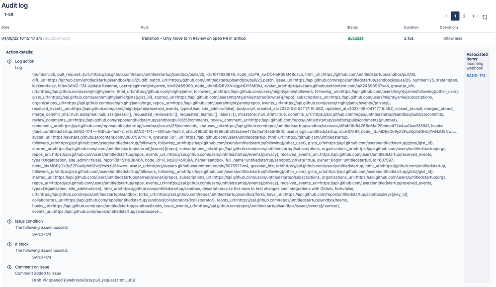

I have automation to check if the Github pull request is opened as a Draft and not transition the ticket but instead add a comment.  I see a single webhook on the Github side but the automation rule runs twice which is adding multiple comments (even with the prevent duplicate checkbox to only add a single comment).
Github webhook:

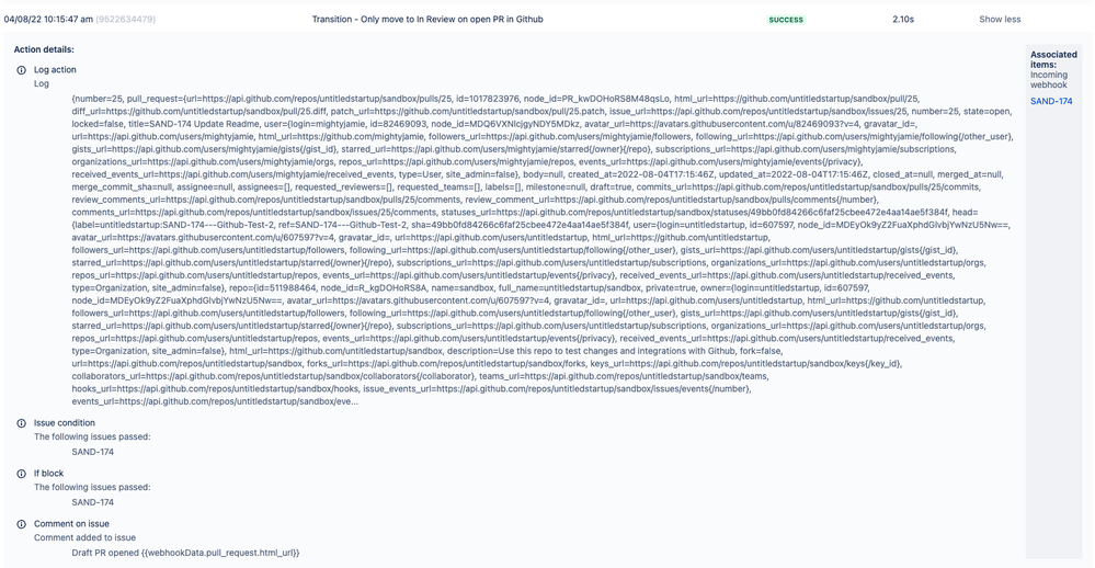

Rule log

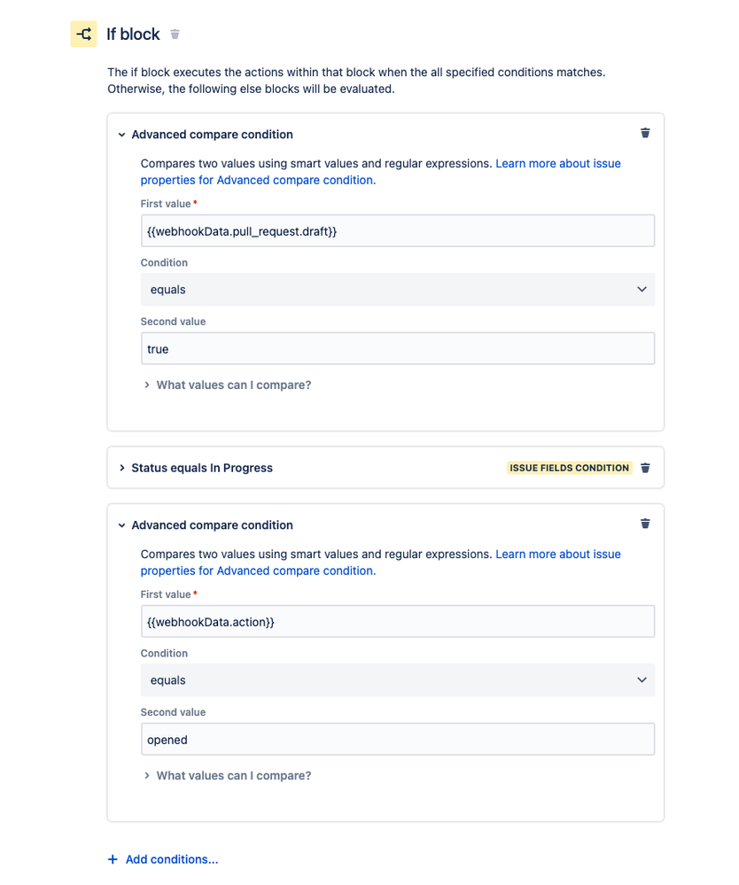

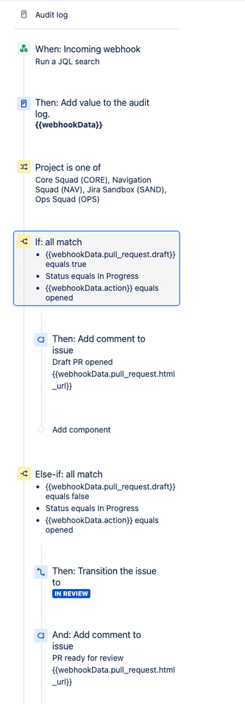

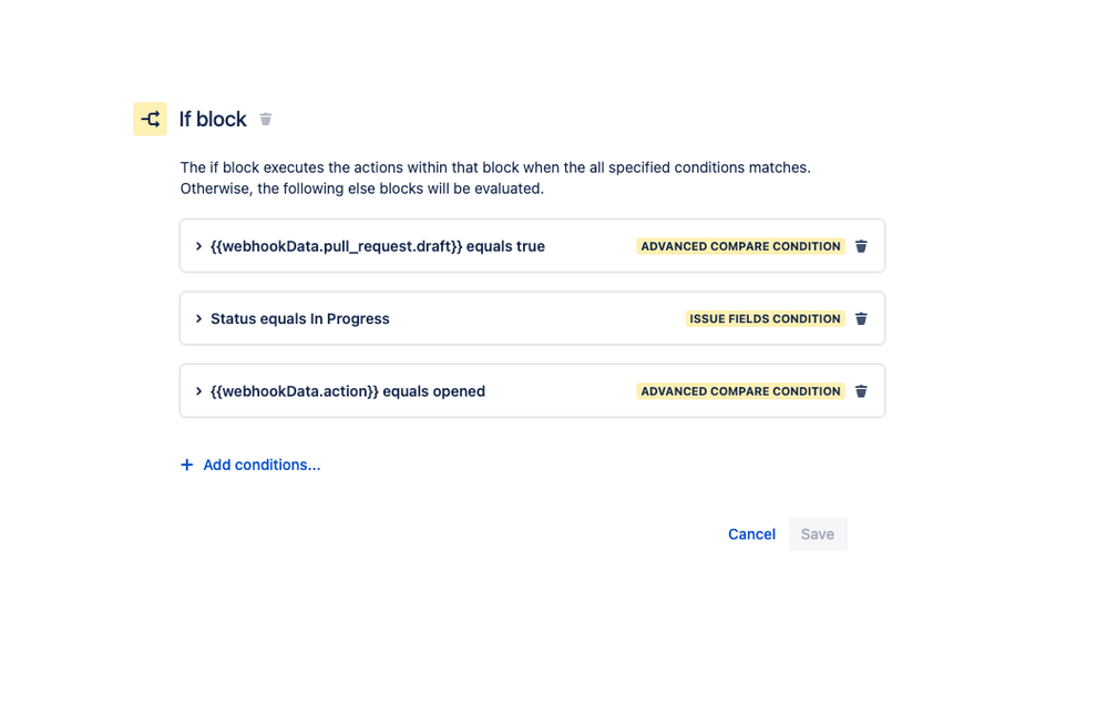

Automation rule:
Screen Shot 2022-08-04 at 10.43.07 AM.pngScreen Shot 2022-08-04 at 10.43.36 AM.png

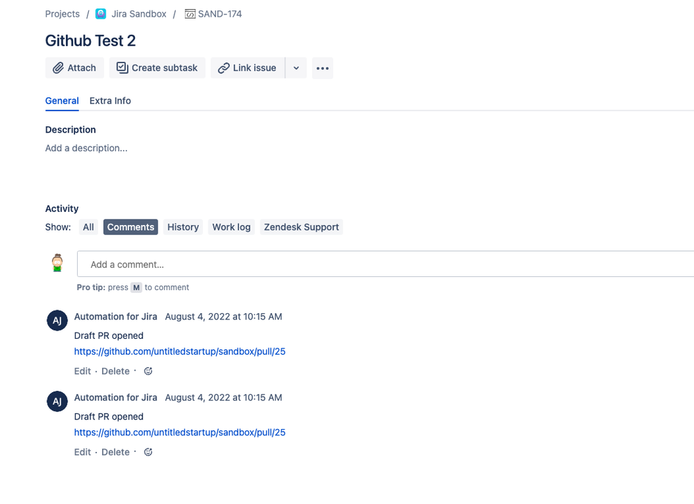

Ticket
Any ideas on how to prevent this? Thanks!
jamie
August 18, 2022
The solution was to check to make sure you don't have multiple webhooks coming from Github for the same type of hook.  When you add a webhook to a specific repository and then one at the organizational level, they both fire causing duplication in Jira.

Hi @jamie ,
couldn‘t find your „pull_request.actions“ in the payload.
Could you also write those values that you are comparing to the the action log?
Furthermore:
Are the compared against string or boolean true?

jamie
August 4, 2022
action log:
action: opened. Draft: true
Here is what I am comparing
I think that once it fires, it's working as intended.  I guess my question is why are there 2 entries in the Audit Log for the same ticket at the same time when only one Github webhook fired?

jamie
August 4, 2022
I think I figured it out.  I added a webhook to the Github test repository while testing and then when I finished, I added the webhook to the org but forgot to remove the test one. So I think the webhook was actually firing twice from Github but I was only looking at one queue.  Removed the test one and things look promising.  If not, I will grab the screenshots and any else I come across.  Thanks for your help!
