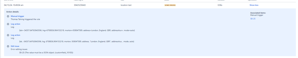

We are trying to setup a simple clone of tickets, in the ticket we have a vendor app custom field called "location" (customfield_10105)
When trying to clone this field i get
(The value must be a JSON object. (customfield_10105))

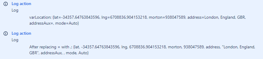

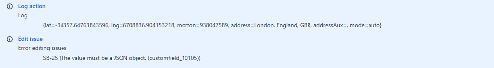

For testing i created a test automation that manually triggers, stores the location in "VarLocation" outputs the "VarLocation" to the logs and then edits the field with advance Json editor:
"fields": {
"customfield_10105": "{{varLocation}}"
Logs:

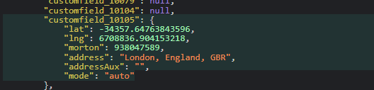

Rest API:
Vendor app (Maps, Locations and Territories for Jira):
Maps, Locations and Territories customer documentation - Confluence (atlassian.net)
Any ideas out there? :)

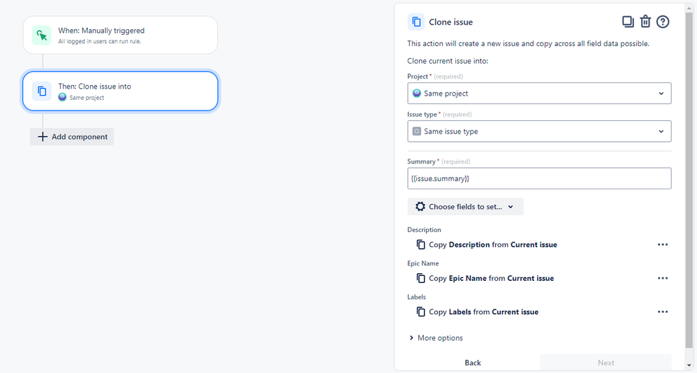

@Thomas Talving have you tried creating a manually triggered automation to create a clone of the current issue? Then under fields to set chose "location" (customfield_10105) copy from current issue.
The location field isn't showing up as a field. so need to use the advance editor to access it. Because its an app, they have a custom type called - Object - Location
Otherwise this would 100% be the way to go. :)

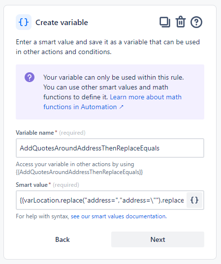

I created a new variable with the smart value
{{varLocation.replace("address=","address=\"").replace(", addressAux","\", addressAux").replace("=",", ")}}

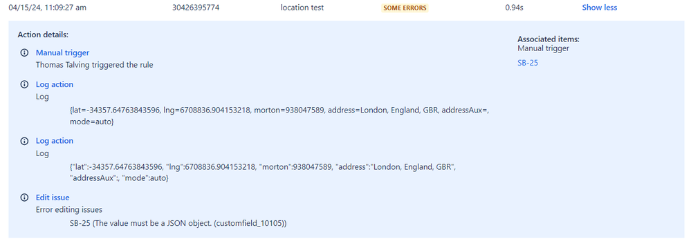

I think I made a mistake and it should be replacing = with : and surrounding the key names with quotes, try this:
{{varLocation.replace("lat","\"lat").replace("lng","\"lng").replace("morton","\"morton").replace("mode","\"mode").replace("address=","\"address=\"").replace(", addressAux","\", \"addressAux").replace("=","\":")}}
Same issue, Got contact with the vendor now but they didn't have a solution. They are apparently looking into how to do this.
