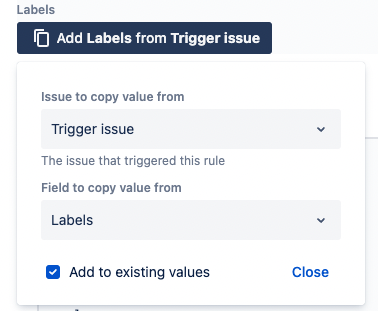

I'm building an automation that creates a new ticket based on ticket activity. I'd like to copy the labels from the trigger issue and also add a new label to the newly created one.
With using the Add Labels from Trigger issue (by selecting the Copy -> select Add to existing values):
and trying to set the labels in the Additional fields section:
I'm getting the following error:
Field 'labels' cannot appear in both 'fields' and 'update'.

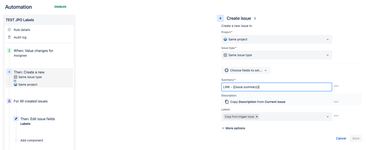

Here is how you could do this using the Branch in automation:
The first action Creates the issue, copying the labels from the trigger, then the Branch is set on all Created issues in this rule, so whatever you put under there is going to happen on the newly created issue.

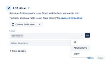

There I put another Edit Issue action where you can just provide the new label to be added:
Works on this end, hope it helps you!

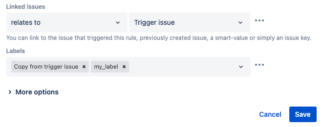

I just realized that using branch is not even needed, using the function Copy from  trigger issue when defining the Labels lets you add additional values:
Anyway, thanks for hinting the Branch functionality!
