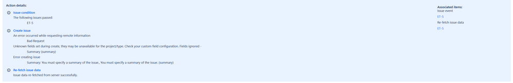

And I get the following Error:Automation_Sub-Task_Leucht_error.png
What is wrong with the automation?
Cristian0791
September 30, 2024

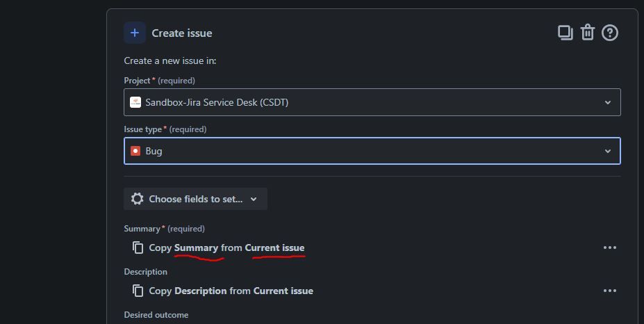

Hi Tiziana,
Please go to "Then" tab and check if Summary is copied from trigger issue:
Hope this helps.

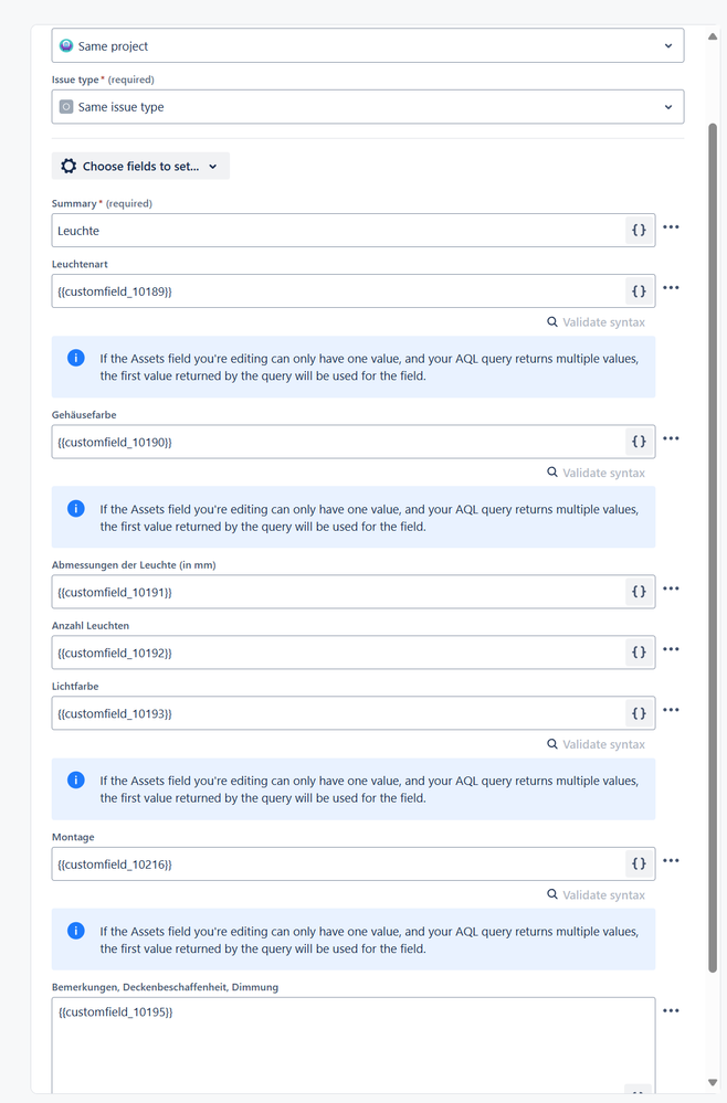

@Bandarupalli Sai Thank you for your help. How exaclty do I use smart values to reference from the transition? I set the fields like this, but it doesn't work

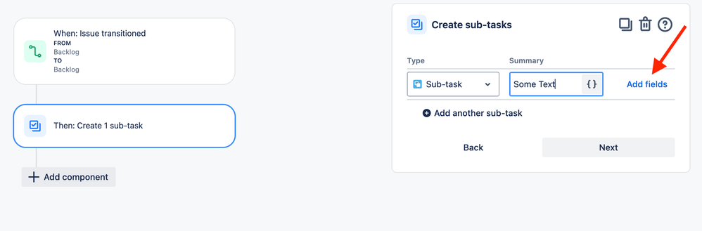

@Tiziana Pisenti - You have to select the sub-task issue type from the issue type drop down or use/select the "create sub-task" option under action as shown in the below screenshots
  • Summary can be any text or can be copied from the parent issue.

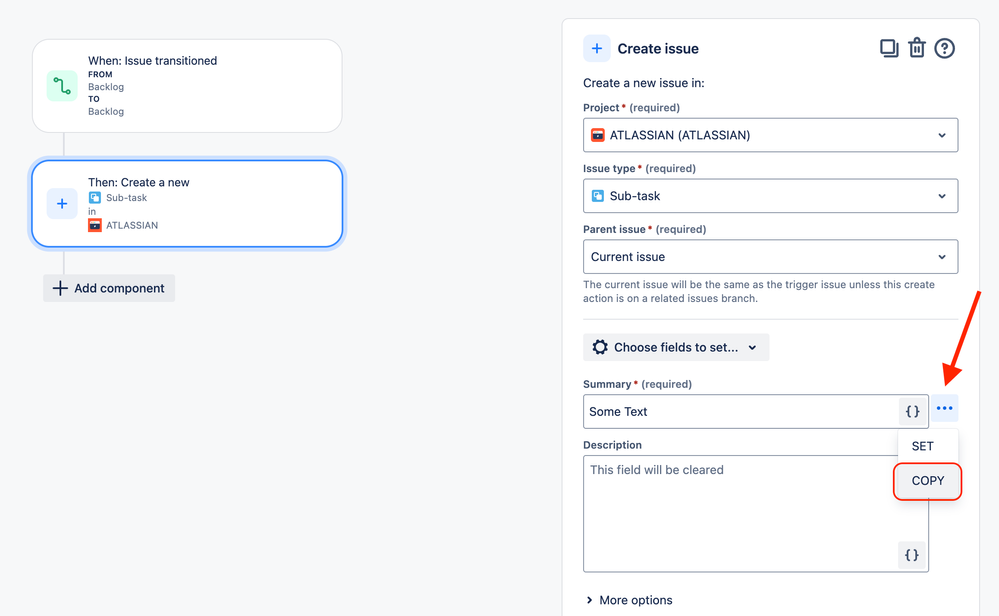

  • Click on "add fields" to add/copy the field values from the parent issue or some custom text or other values. You have to click on three dots to see the copy option as shown in below screenshot

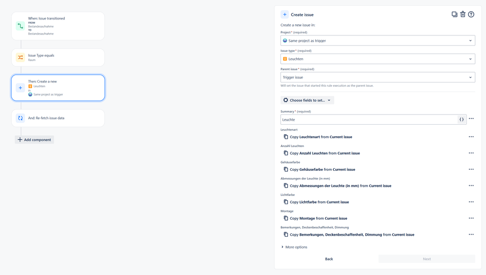

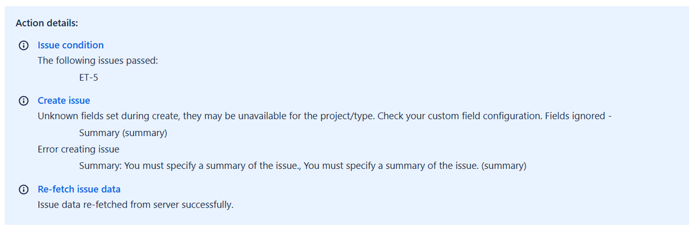

@Bandarupalli Sai there is an issue with the summary:
Bandarupalli Sai
October 3, 2024
@Tiziana Pisenti - Can you share the rule screenshot?

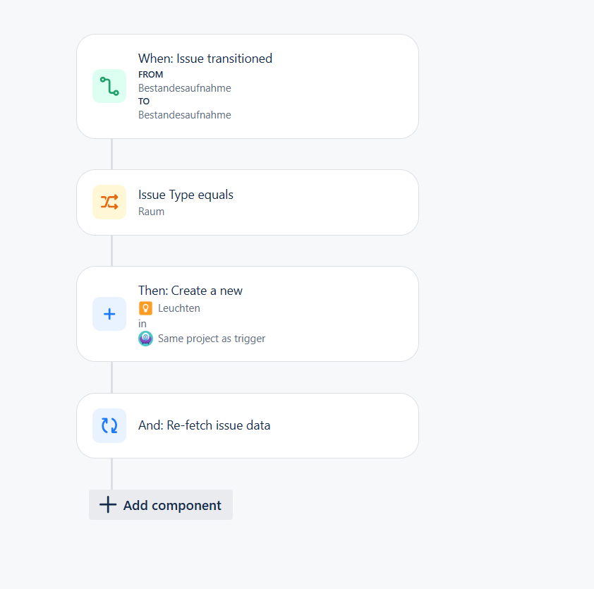

Tiziana Pisenti
October 3, 2024
@Bandarupalli Sai here you go:
Bandarupalli Sai
October 4, 2024
@Tiziana Pisenti - Can you check and ensure that the Summary field is not hidden or restricted in the respective issue type Field Configuration?
