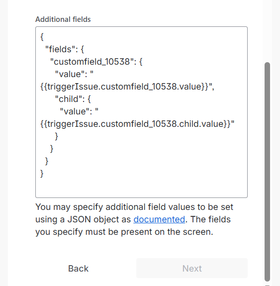

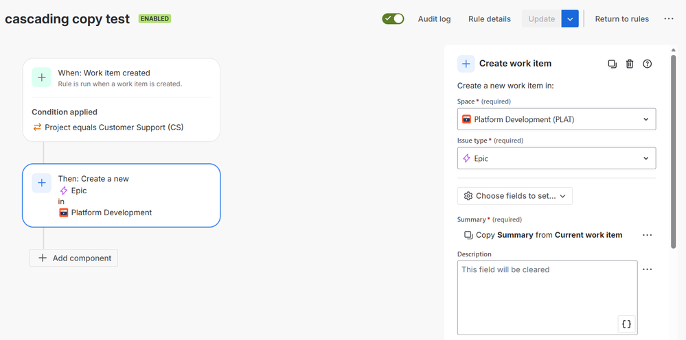

Use the below
"fields": {
"customfield_10538": {
"value": "{{triggerIssue.customfield_10538.value}}",
"child": {
"value": "{{triggerIssue.customfield_10538.child.value}}"
works fine and creates the epic in the other project and copies the cascade field values. use your own custom field.
Hope this helps!
