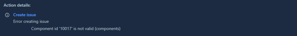

My automation has start to fail.
I am creating one issue from one projekt (JSM) to another (Software).
In the automation im copy components. But since I have updated my list of components this does not work anymore. Whats is this error message related to?
create dev.pngHow can I see components ID - and can this be changed?
Regards Kajsa

Kajsa Fransson
May 15, 2024

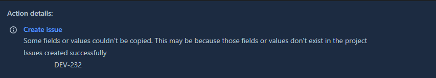

Im only copy components from one project to another. It worked until (I guess) updated the name of one of the components and added another. But I guess it was just until today when I updated the issue layout it trigged.
My issue is created now but the field "components" its not copied.
My list looks similar, but I guess its something with the IDs.
By following your instruction im not able to see the ID...I guess im missing somthing,

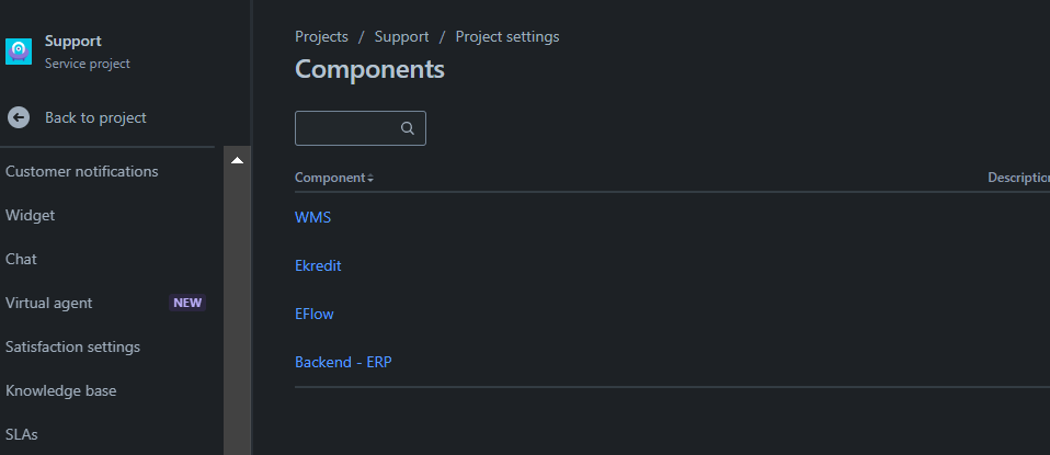

Kajsa Fransson
May 15, 2024
@Michal Switala
I found how to get the Component ID now. No one has the same ID.
For ex
Projekt 1 WMS =10012, Ekredit = 10014, EFlow = 10016, Backend = 10013
Projekt 2 WMS =10011, Ekredit = 10009, EFlow = 10017, Backend = 10010

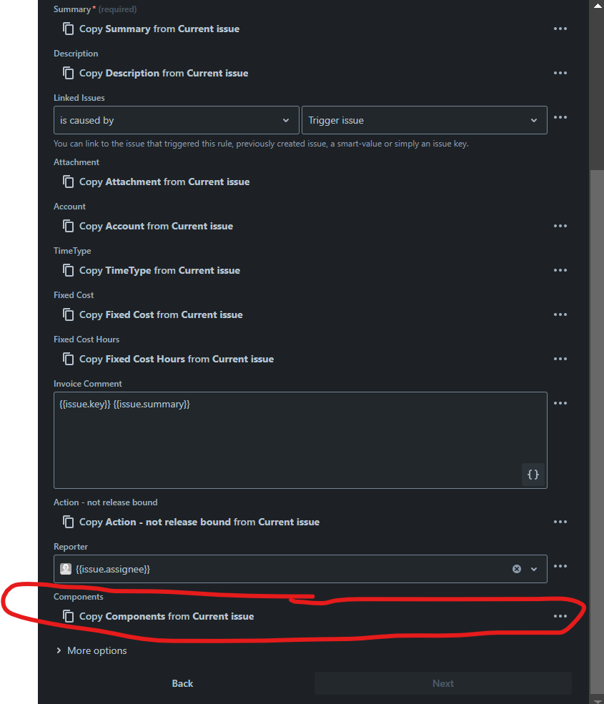

Kajsa Fransson
May 15, 2024
If I changed from Copy to Set "Smartvalue" it worked. So problem is solved. BUT really strange this didnt work from one day to another...

Hi Kajsa,
I'm glad it is working now! sure it was not an easy one.
I tried to reproduce this, but if you got it solved then never mind.
When you run into error "some values couldn't be copied" when using Jira automation then it means these values might be removed for example. Always you can compare old issue with new issue and compare which fields are missing and try to make sure they have these fields so you can copy them between.

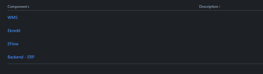

Kajsa Fransson
May 15, 2024
Hi,
The structure are the same on both sides. It has work in months.
Last week I updated with one more components. It worked.
The only thing I have done today is that I re-arrange the field "components" on the issue. Could that effect the case?
