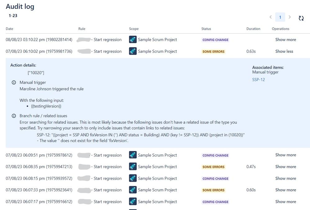

Maroline Johnson
August 8, 2023
Hi @Bill Sheboy
Here are those images. I hope they help.
I meant "the automation just won't run" as in - I would try to trigger the automation from an issue, and instead of running, a pop-up appeared that basically said "Oops, we can't run this automation." I've fiddled with it a bit more, and it's running now, but I can't say for sure what I changed to get it to run.
In this sample project, the versions do have a space, so I added the parentheses and quotes. I tried double quotes and single quotes. In the audit log screenshot, you can see now what's causing errors.

Thanks for that information.  Would you also please post an image of your rule trigger?
I suspect the problem is the Variable Name in the trigger's input fields has curly brackets around it...but it should not.  Instead it should be just be testingVersion, like this
And after that is fixed, I believe you need to use double-quotes, not single-quotes, in the JQL.

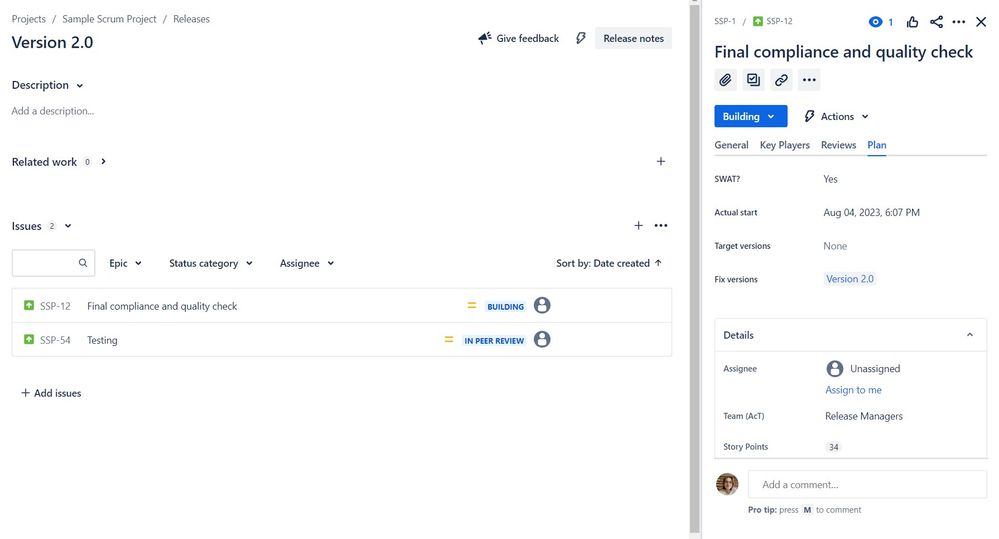

Here's a screenshot of the test issues I'm working with. I ran the rule from SSP-12, put Version 2.0 as the testingVersion input, and expected it to transition, but it didn't. The audit log says no related issues were found for the branch JQL. I thought that SSP-12 would be found.
project = {{triggerIssue.project.key}} AND fixVersion IN ("{{userInputs.testingVersion}}") AND status = Building

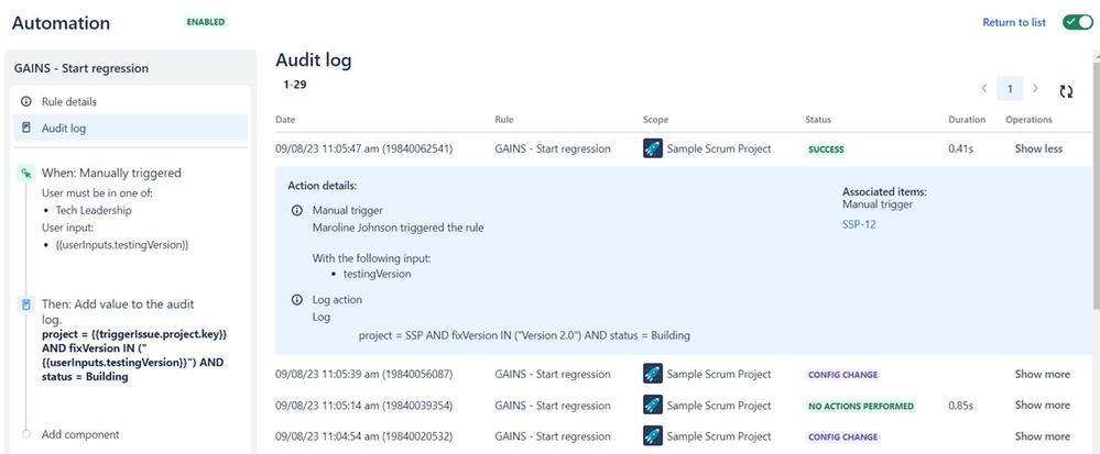

I changed the automation - removed the branch rule, removed the transition action, added add value to the log: the same JQL I have been using. Here's what I got.

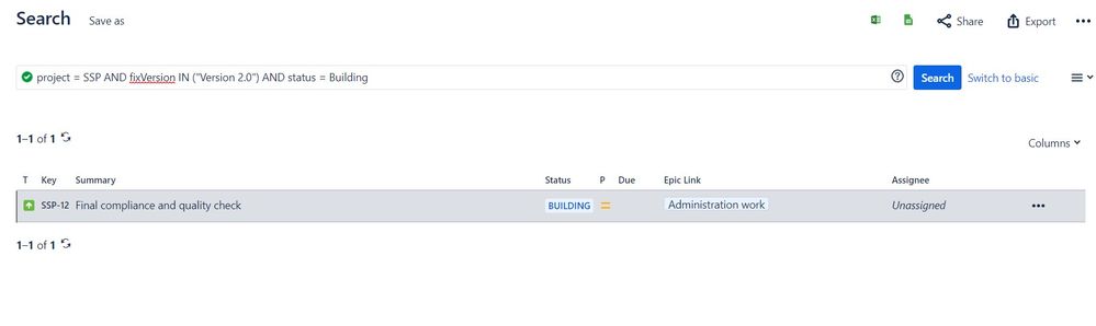

Then I took that JQL and did an issue search and got this.

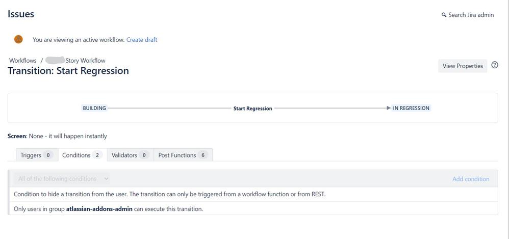

It seems like everything should work properly. I know that in the workflow there are some conditions limiting what users can do a transition. A while back I ran into a different problem where an automation was unable to transition an issue, and I found out that I needed to include in the conditions that atlassian-addons-admin can do it. I already changed the transition here to include that.
That condition is set so that All conditions apply. I tried Any too and still no luck.

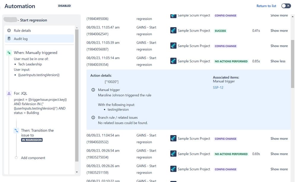

Would you also post the audit log from before you removed the branch and the rule did not find anything?  That will show us the complete flow.  Thanks!
By the way...another thing to try: rules can sometimes get "glitched" by too many edit/save/publish cycles and so they stop working.  There is something in the rule editor which seems to cause this.  The work-around/test for that problem is to disable your current rule and re-create it from scratch, and then test.
Maroline Johnson
August 9, 2023
Sure, here's that log.

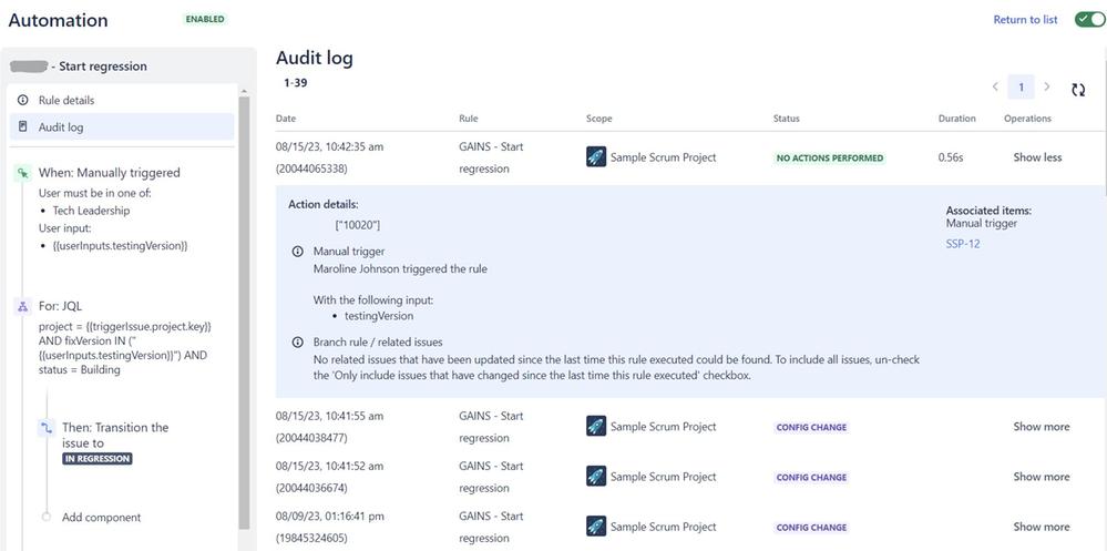

That box has been unchecked. I tried running the rule with that option checked and got this instead:
I really appreciate all of your help. It's so strange to me that this isn't working.

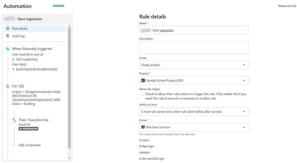

Let's put these two tests together to learn if we are missing something obvious:

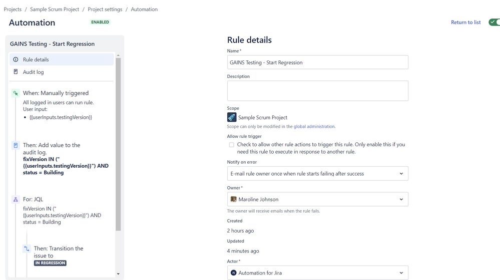

After your trigger, and before the branch, add a write to the audit log with the JQL you are about to use in the branch.  That will confirm, in context, what the branch is about to use.  Then run your rule and post an image of the audit log details.
And...would you post an image of the rule details section, showing the actor and scope of the rule?
Maroline Johnson
August 16, 2023
Ok, so I put a second issue into Building and the same version, and the automation worked for the other issue, but not the issue that I triggered the rule from!
Here are pictures:
start regression test audit log details.jpgstart regression test rule details.jpg
This is a good development. I could just add another transition action into this rule so that the trigger issue is transitioned as well.
