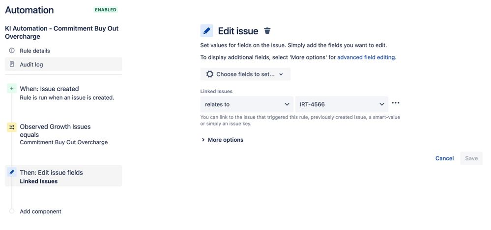

I am trying to create an automation where when a new issue is created and has a specific filter met, then this new issue links to a specific issue key (in this case IRT-4566 is the issue I want to relate to). I've included a screenshot of what my automation looks like right now, but it is not working when I test this automation. Can someone advise if my syntax is wrong or if there is a different way to automatically have a new issue link to a current issue?

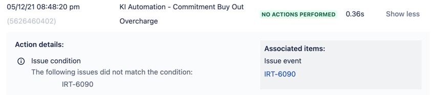

Concerning the audio log, from what I see is that the rule worked just fine. It's just the issue didn't meet the proper condition. So my question is, when exactly you enter this value of "Commitment buy out.... "? Is this value entered on the create screen of the issue? Is this value is entered via a workflow PF? Or at a later stage?

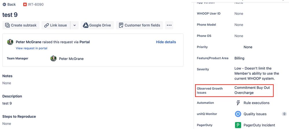

Ended up being that legacy automation is needed for this because the selection criteria is a part of a dynamic field that populates dependent on another selection from a static field on the form.
Thanks for your help! If there is a known way or it is being worked on that regular automations can work for dynamic field selections instead of having do to a legacy automation which waits for an issue to be submitted for 1 minute and then runs the rule, that would be very helpful! This work around works for now though.

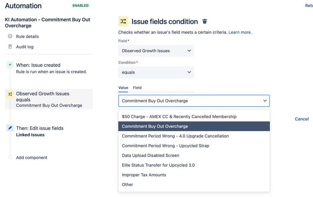

2. From the audit log, it looks like the issues I am submitting that I think should be meeting the filter condition are not doing so, as the audit log is showing "NO ACTIONS PERFORMED" for all issues and saying "the issue did not match the condition". (audit log screenshot attached).
I do not understand why the issues I am expecting to meet this automation's condition are not doing so. Attached is a screenshot of the filter condition, and an example of an issue I have submitted that is not meeting the condition. 568062C3-3659-40BD-AA21-0ADD08991A50.jpegFF6A976D-BCFF-4F98-A7F3-0FDB8AA6F0E4.jpeg891D0919-9055-49D0-B283-99E7D47B4E53_4_5005_c.jpeg
