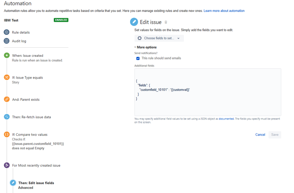

I have been trying to make this automation work for too many hours and need help! I know it can be done, but I am missing something. I found a bunch of examples, but none worked unfortunately!
Steps:
  1. Create a new story under an Epic where the custom field (Team) is already populated
  2. Upon creation, match that Team name with the parent issues' Team Name.
  3. New story created and has the custom field (TEAM) filled out.
Sounds easy.. but I am STUCK!

First, your rule is branching to "Most recently created issue" but no issues are created during the rule; that is the purpose of that branch type.  The branch may be removed.
Next, your rule is referencing what appears to be a Created Variable by it has not been defined anywhere.

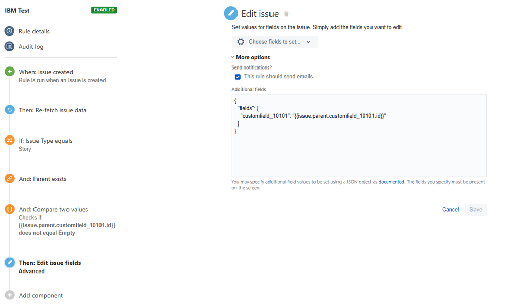

Assuming your "Team" field is customfield_10101, please try this:
  • trigger: Issue Created
  • action: Re-fetch Issue
  • condition: Issue Type equals Story
  • condition: Parent exists
  • smart values condition:
    • first value: {{issue.parent.customfield_10101.id}}
    • condition: does not equal
    • second value: leave this empty
  • action: Edit Issue, using this JSON
"fields": {
"customfield_10101": "{{issue.parent.customfield_10101.id}}"
Kind regards,
Bill

Still not working - used the straight code and tried to replace with team # (4379)Screenshot 2025-02-07 143251.png

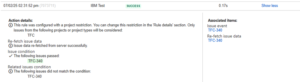

Please post an image showing the audit log details from trying to run the rule.
Also, have you confirmed that is the correct custom field ID for your field?
Like Isabella Musial likes this
Isabella Musial
February 7, 2025
yes, customfield_10101 is correct.
I tested on 2 different projects - neither inherited the Epic's team name.
Bill Sheboy
February 7, 2025
I just checked the public backlog and it appears copying the Team field with an automation rule using the Server / Data Center version is not supported yet:
https://jira.atlassian.com/browse/JIRAAUTOSERVER-159
https://jira.atlassian.com/browse/JIRAAUTOSERVER-779
https://jira.atlassian.com/browse/JIRAAUTOSERVER-1093
The JSON approach appears to only work with Jira Cloud.
